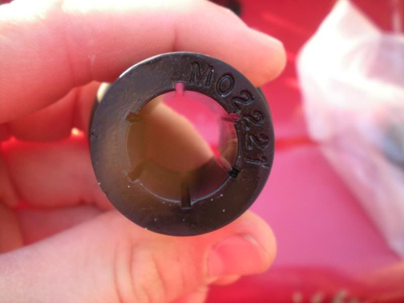

And Jake, thanks a lot for the great pics of your greasable bushings and bolts! I sent you a thumbs up for those .
Originally Posted by YJake View Post
Bushings with cut outs for grease.
I think the OME bushings I got with my lift will work fine with the greasable bolts. They seem to have similar cuts in them for grease (Although, I don't think they are on the inside of the bushings). Does anyone here see any problems with that set up? I'll try to get a picture up close of the OME bushings, for a side to side comparison.
