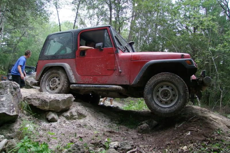

Here she is. You may want to think about extending the brake lines as well. When the front is fully flexed out like the pic, the stock lines come pretty close taught.....Also watch how you keep the brake lines from not being caught up in the sway bar once its disconnected...
My co-pilot agrees
