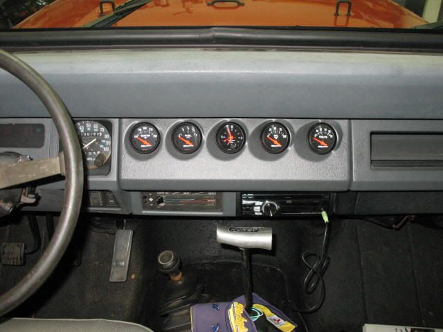

These work well with my 350. Autometer Phantom. Very accurate and not terribly expensive
How can I resize these images so I'm not taking up so much space?
92 YJ, 350/350 Chevy, AX-15, Skyjacker 4", 4.10s, CJ style flat dash with Autometer Phantoms

I used autometer gauges with my 350 swap.
That looks good!!

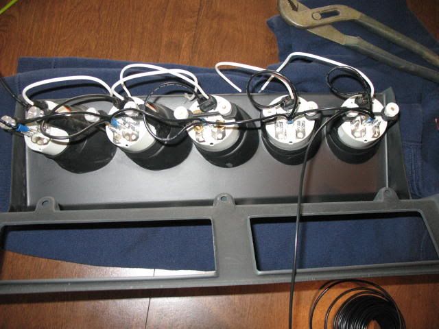

Our old YJ...
I never bothered painting it to match.
Switches were for rock lights and incab winch controller.
Martin

post #15 of 16 Old 08-21-2011, 01:28 AM
Bigyellow4x4
Location: Moses lake
Posts: 1
Were are the piece they mount to coming from making it or buying it?
