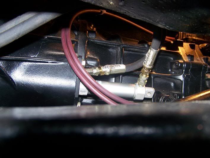

You can make your own. You can make it from hard brake line, or soft brake line, or have a length of hydraulic hose made by any hydraulic shop (yellow pages), just don't make it out of any soft hose that will expand from the pressure, even pressure fuel line won't work.
Here's an example of an installation I did about 2 years ago, the cylinder is different from yours, it's a double acting cylinder and the front hose is only used as a vent. The rear hose is connected to the master cylinder - it all works great

I don't know if ive ever seen a jeep so clean underneath..... its almost a shame!

That was a complete rebuild - I don't like working in grunge, the whole thing looked like that.
