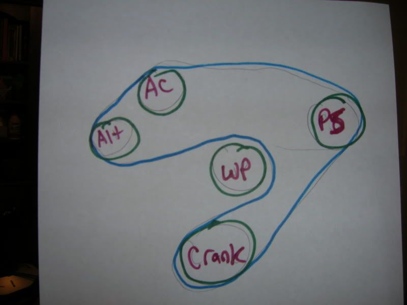

how to put the serp belt on
how do you put the belt back on? which direction and everything..

yea do that but if you need a routing diagram here is how mine does i have a 4.2 with ac
