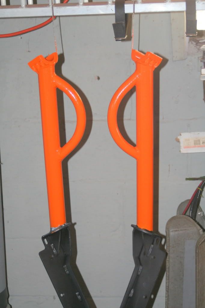

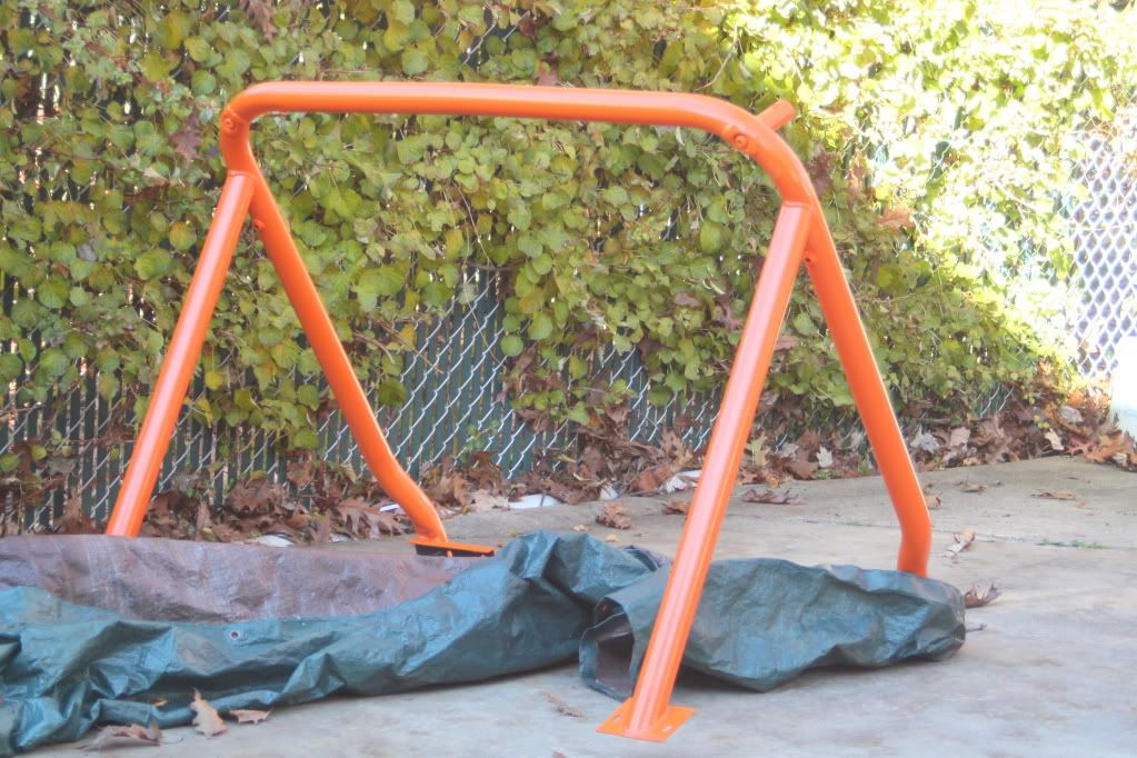

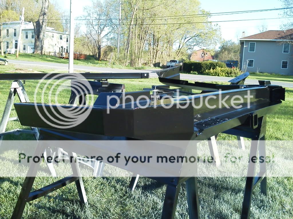

I'm still in the middle of doing mine, but what I did was to use a black roll on bedliner on the interior, and a black spray on bedliner on the entire exterior of the Jeep.
Then rolled over the bodies exterior and the bolt in cage pieces, with a white colored primer, followed by a safety orange Rustoleum topcoat...I figure it will be fairly easy to touch up if needed.
My frame, rockerguards, and bumpers will stay black.
in progress pics:
here you can see the white primer on the interior side of the windshield frame (leaning up against the wall)
Orange Jeep Club #88

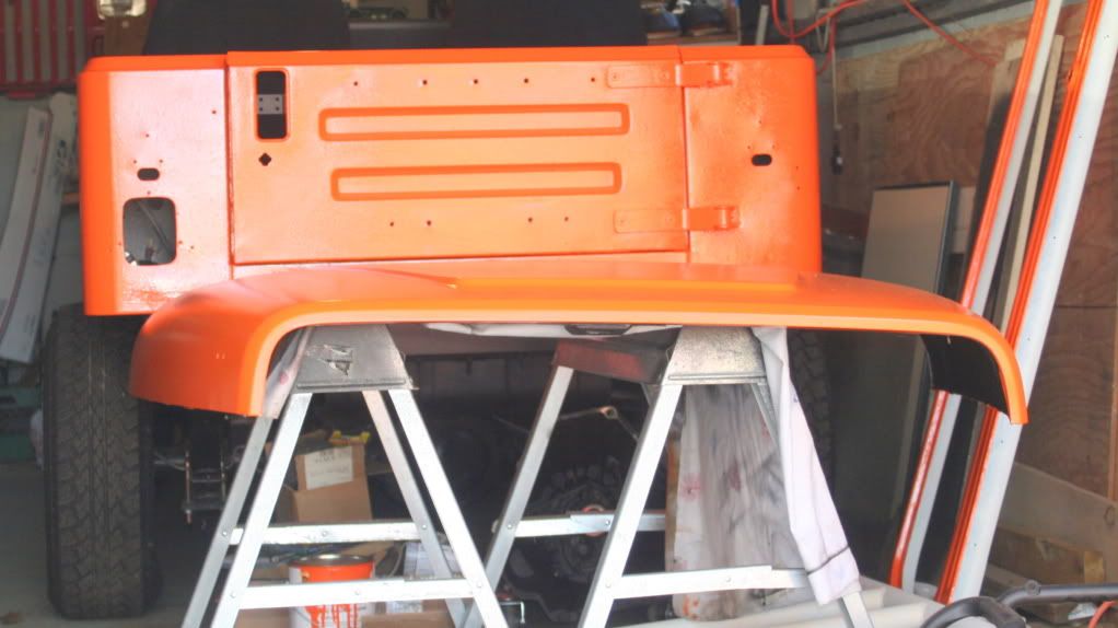

here it what it looks like with quality prep and paint... AND yes u have to look close.
