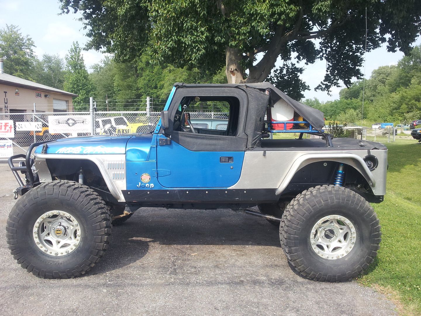

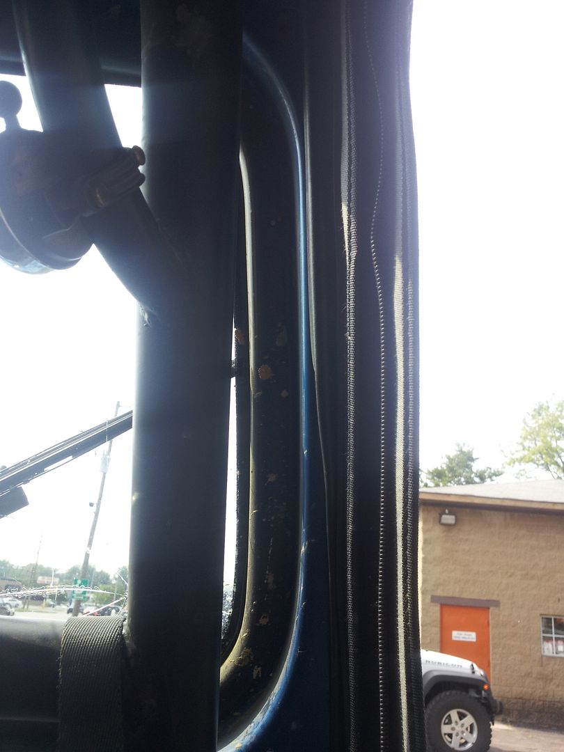

post #64 of 96 Old 06-04-2012, 03:40 PM
BadHairDay
2010 CJ8
Location: LouEVIL KY
Posts: 13

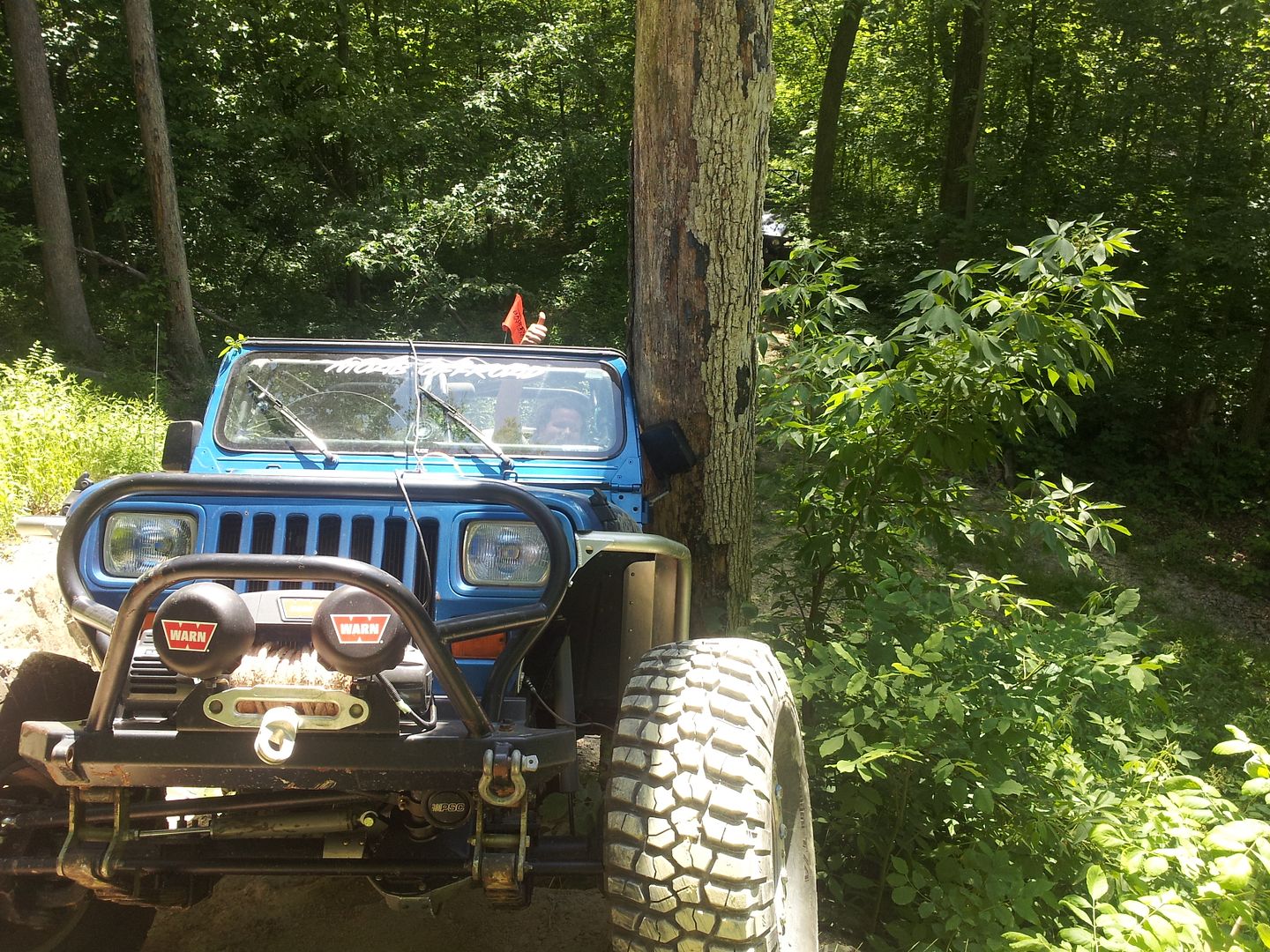

I didn't use the plastic windshield pieces and have had no problems sealing at the windshield frame. However all of mine needs to be RE-adjusted due to trees jumping out in front of me wheeling. LOL!
