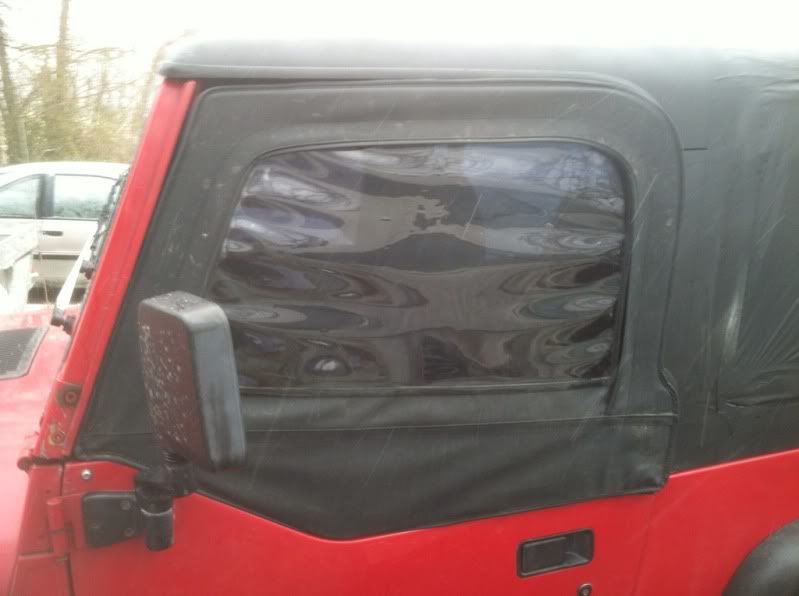

Bringing this back up. I'll post pictures as soon as I get home but I'm having a hell of a time getting this to work. Picked up some tj uppers on craigslist, they appear to be oem. Cut the rear peg off and installed them. It just seams there's no amount of tweaking to get these to sit in right. The doors are vey hard to open and close. If I take the canvas off of the frames they do fit but are tight in some places. It's starting to get cold again here in Ohio and with the doors not sealing the jeep doesn't stay warm at all! Any help would be great.

as you can see, I've got about 1/4 to 3/8" front, and a full 1/2" rear. As I remember from doing this (been a while) I adjusted the hard top front to back, and the distance from the pins to the metal flat bar at the bottom (so it sat just a little lower). the front was always a little tight, but the rear was never a problem, even the next year when I put the hard top back on for winter. try adjusting everything with the canvas off to make it easier to see whats going on.

Here are the pictures of my jeep.
I still need to weld the 3rd peg back on and I think that might have something to do with the partial gap around the bottom of the door seal.
