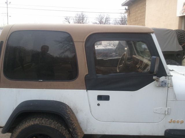

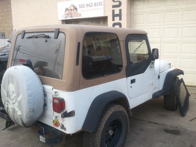

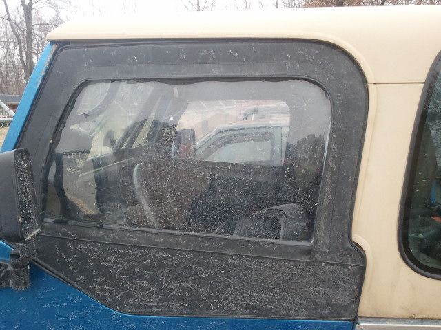

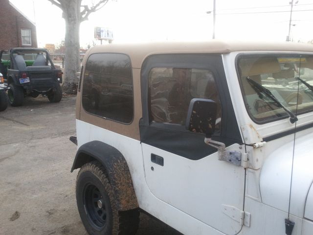

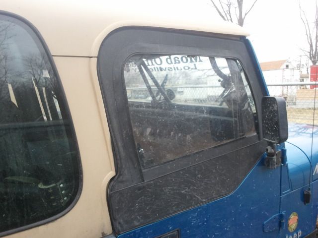

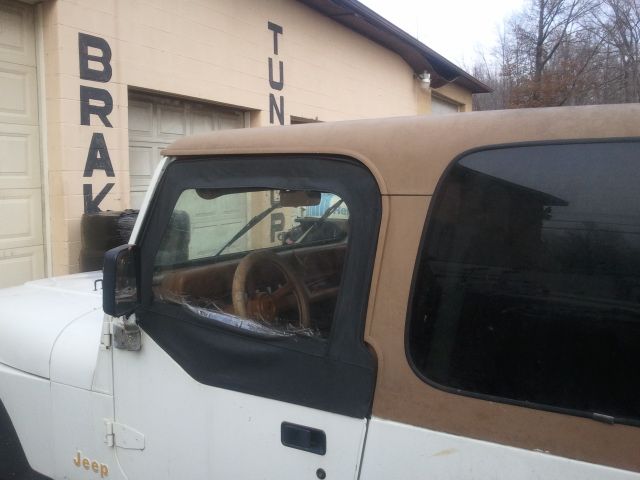

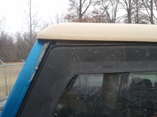

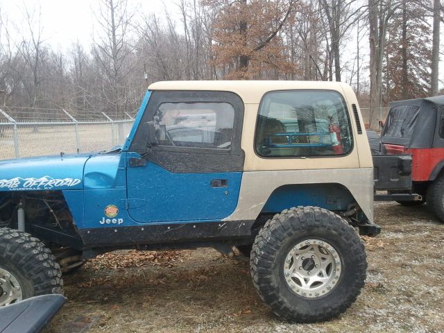

Nice thread I just saw this tonight due to google. I've been running a TJ Viking soft top on my YJ for the last year with TJ soft Uppers and just test fitted a YJ hard top to them. The soft upper mod was the same as you did and we just did another one for a customer today. The TJ upper door frame mod takes about 30 min. a side. Here are some pics of my blue YJ.
And here is a customer's that we did today.

Great thread by the way hope this encourages more people to do this mod.
