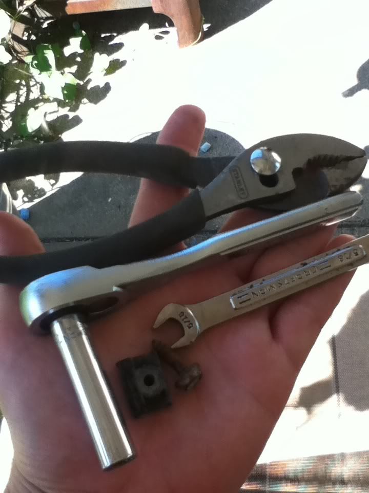

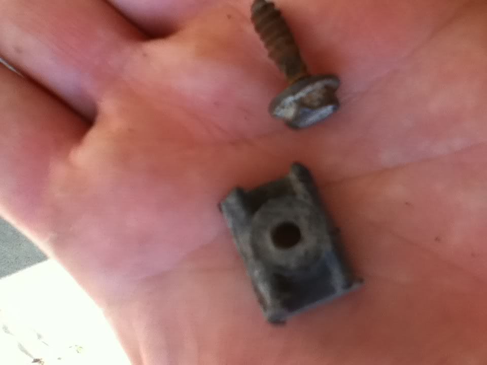

talk about using an old thread, but this helped me today.... thought I'd add a little bit though in case anyone else was searching for this. on my 91, the bolts were a 5/16, needed a few tools to remove them and it only took about 30 minutes to get both fender flares off the rear.
this is what you are trying to remove
and this is what it took
