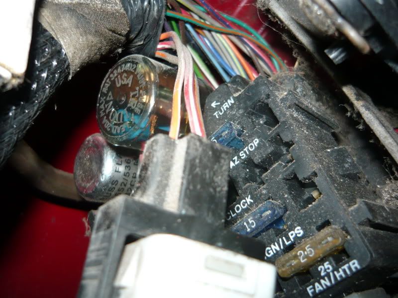

Look up under the dash, above the parking brake mechanism on the firewall. You'll see the fuse panel & it has two round relays on the top of the panel. The one on the left is the hazard light relay, and the one on the right is the turn signal relay. The one in this picture is an electronic relay on the right.

Originally Posted by mean max View Post
look up under the dash, above the parking brake mechanism on the firewall. You'll see the fuse panel & it has two round relays on the top of the panel. The one on the left is the hazard light relay, and the one on the right is the turn signal relay. The one in this picture is an electronic relay on the right.
max
thanks for the help....going to do this soon!!!
