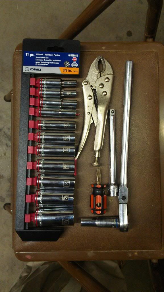

Tools and Supplies Needed:
New Hood Catches: http://www.quadratec.com/products/13004_0402.htm
Vise Grips
Screwdriver(Phillips or Flat-Head with the Smittybilt's)
10mm Socket
7/16 Socket Deep-Well
3/8" Ratchet
3/8" Extension

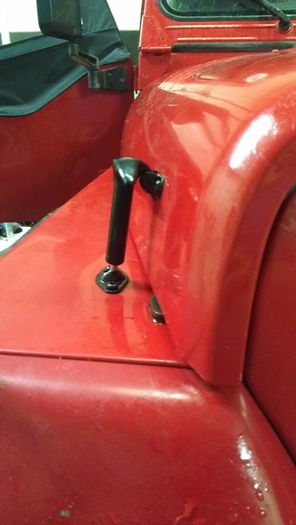

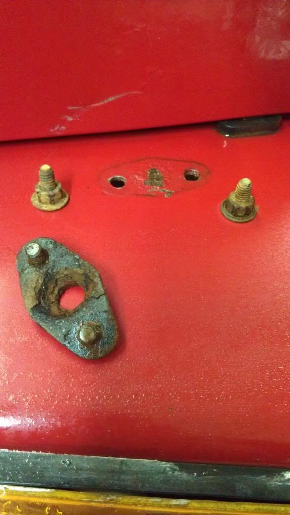

Remove the old "T" part from the fender, 2. 7/16" nuts on the underside. Mine just kind of snapped off.

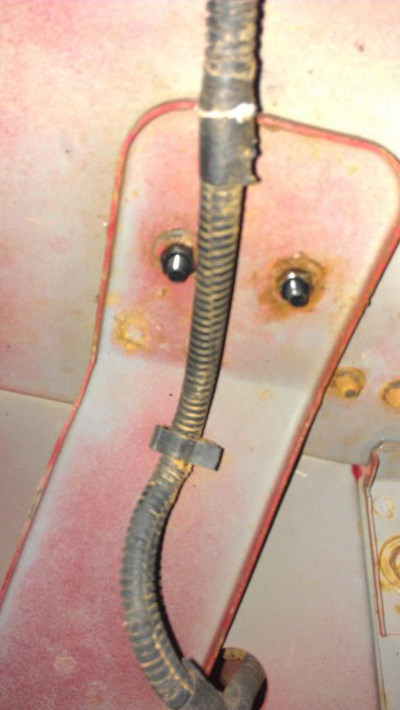

Remove the "U" part from the hood remove the 2, 7/16" nuts on the inside of the hood.

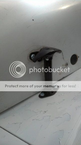

Reinstall the new "U" part with supplied hardware. Tighten by hand and then use the screwdriver to hold the screw and use the 10mm socket and ratchet to tighten down, snug.

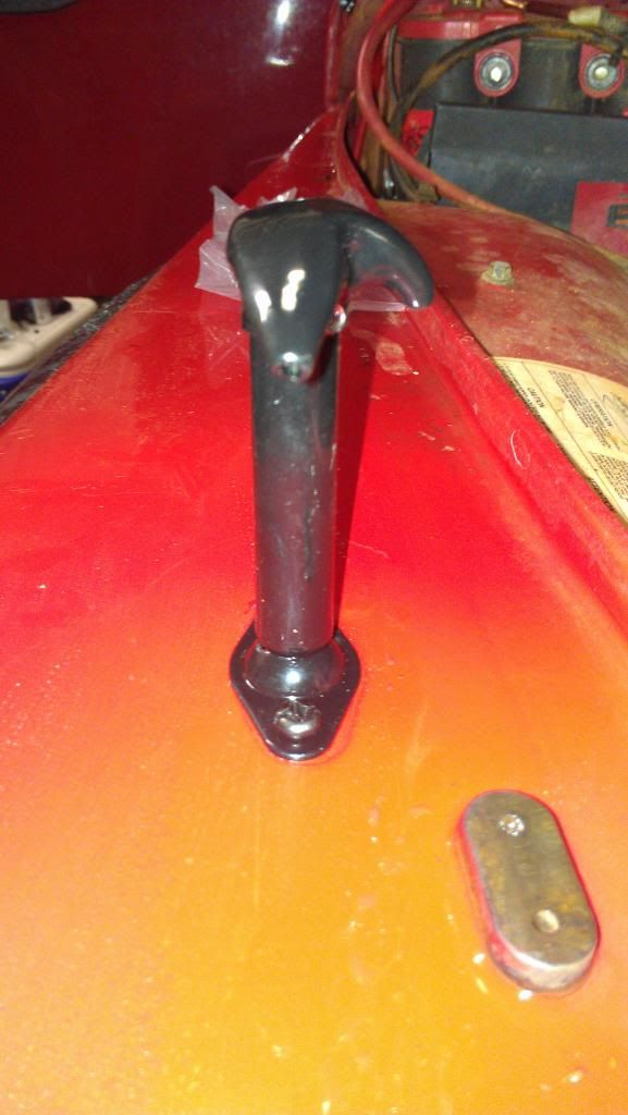

Reinstall the new "T" part with supplied hardware. Tighten by hand and then use the screwdriver to hold the screw in place and tighten snug with the 10mm socket and ratchet.
Make sure you do this to both sides and be sure everything is nice and snug.

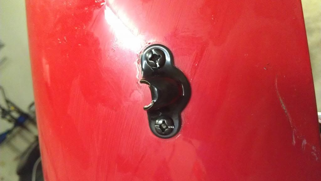

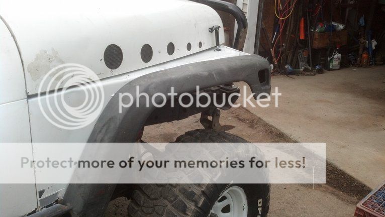

Finished product:
I'm pleased with the look and function of these hood catches. They are easier to put latch them with one hand and don't screech every time I move them up and down. I recommend these to anyone that needs new ones.
