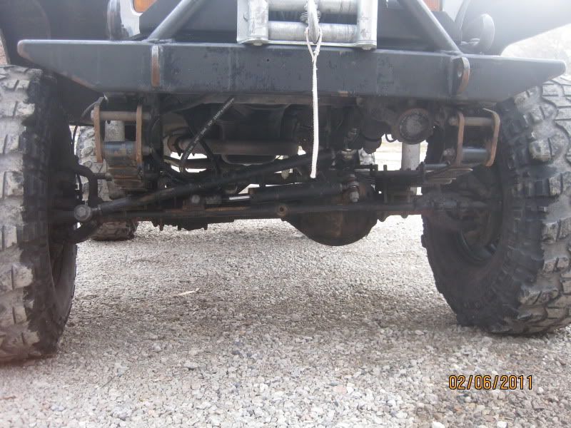

My Jeep Steering looks just plain disgusting now... what it looks like now
After seeing the previous post this is how mine SHOULD look.

I asked my father in law his opinion about it last night. He's not a jeeper at all but is very mechanically inclined. He said "I think you could just bend your draglink into an S curve to get it to clear your leaf"...
I will keep reviewing my options
