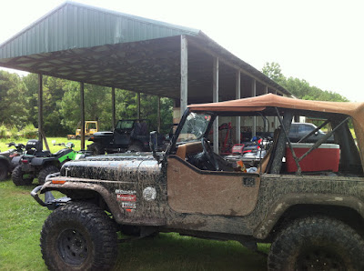

I've always wanted to run a very minimalist top. Living in SC and having a garage, I had been running a safari top all year round with a windjammer in the cooler months. This worked well except in the coldest months. I bought a beat-up bestop supertop and frame last winter and it worked pretty well keeping me warm. I didn't like that the windows were not clear and that my access to the cargo area was much more restricted.
I started running the supertop without any windows late this summer deciding that it was a better option over the safari top because the safari top did not provide adequate protection from the rain.
It'd been my desire for a long time to create some fabricated door surrounds...so that I could keep the open cargo area and also have more of an enclosure to hold the heat in the winter. I'm on my way to having made them and thought I'd share.

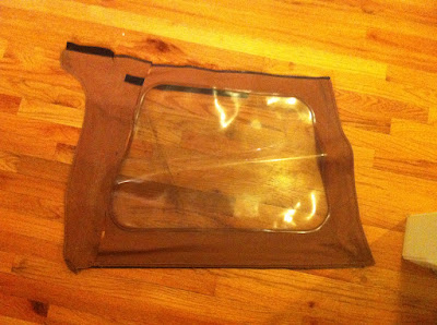

I took my old side windows which were beat up with dingy plastic and cut them at the seam of the canvas and the plastic.
I bought some strap type material at a fabric store along with some plastic buckles of matching size that will be used to connect the edge of the surround to the roll bar.
I then dyed them using some VHT satin black vinyl dye ordered from Amazon. I don't yet have the sewing done on the straps, but here is a mock up of the surround in place. (I also dyed the doors and top so everything would match...my doors and top originally were slightly off...I think doors were tan and the top was spice or nutmeg).
No surround:
Surround mock up:
Before picture of original top and doors:
I might regret going all black...I think I like the look of the contrast of the lighter top and doors to the dark paint. But overall I'm happy with the look and think these surrounds will be perfect! There is a slight gap between rollbar and the surrounds, but should be just enough to vent some of the heat out since the heater throws out pretty intense heat.
