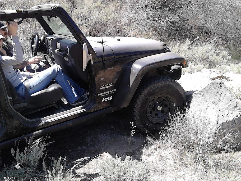

Not much has been going on the last few weeks. Things have been pretty stressful and in my down time I've been helping one of my good friends with his JKU so the YJ hasn't got much love from me. In fact I wheeled it a bit yesterday (just a light duty dirt/rut trail up into the mountains,) and she let me know she doesn't like me cheating on her with another jeep by throwing a temper tantrum and spewing coolant all over the place! Busted the plug welds that connect the radiator to the mounting bracket. Fixed it up with some heavy duty zip ties haha. Now my swaybars, break lines, radiator, coolant overflow, and rear speakers are all held together with zip ties. Cause, you know, I like to keep it classy.
Other than having fun with it, not much has happened. This coming weekend I plan on digging into the 8.8 and getting it prepped. I should have the time to finally install my sound bar and security console as well. But before all that, I plan on flushing my cooling system, checking my water pump/thermostat, and making a trip to a JY to find a Taurus fan. I don't want to risk overheating again! Oh and my disk breaks are squeaking bad now...guess it's time for new pads.
It's never ending haha. Part of the fun of driving and wheeling a 20 year old YJ
Cheers
EDIT: A few pics as promised
Driving up...really bad wash board road at the beginning. Like those highway rumble strips on steroids.
Giving my baby some love while the JKs pose...
Justin decided to mess around while I was letting the YJ settle down after her fit.
Then he got owned by this rock...He was digging with his back tires and spinning the front till it was smoking with out budging. It smelled a lot like lockers coming down the pipe...

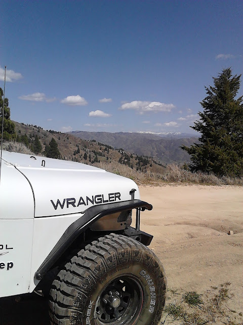

Got back on the trail with an awesome zip-tie trail fix, and made it to the summit. Great views!
And the way down
Ta-da! Pictures!
