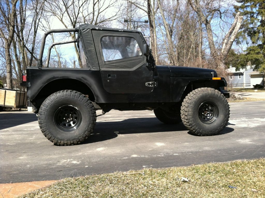

Awesome job on the jeep so far! You've done a good job at picking quality parts for our rig, (OME leafs, Bilstein shocks, SYE...). I run OME leafs and 1/2 shackles for about 3" of lift on 35s on my YJ, I love this setup! It's super stable offroad and handles Better on the hyw then stock. I did have to do quite a bit of trimming to the fenders but I also have 2" of stretch in the rear so you wouldn't have to cut as much...
I see your having trouble finding an 8.8. How many 97-02 jeep XJ's are in your area? They have a 29 spline Chrysler 8.25 rear axle, it's plenty strong for 35" tires and can be had for free-$100. They do have drum brakes but you can swap ZJ disk on it. I run this axle with 4.56, Detroit locker, disks and its held up to some hard wheeling/heavy pedal. It's a extremely under rated axle and is as strong as a D44 for a fraction of the price of a D44 or 8.8. Just a thought if you can't find a 8.8.
Here's a pic of my rig to give you an idea of what your rig will look like with no BL. OME 36R leafs, half inch shackles, 35s and lots of trimming. 96" wheelbase.
