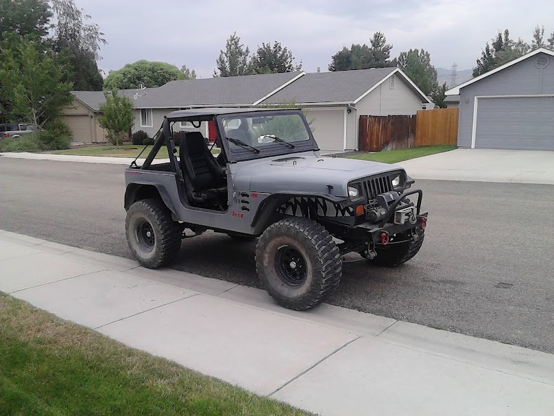

So my pinion angle on my 8.8 was a little off. Long story short, my daughter broke her arm the day I was installing it a few months back and my head wasn't in the game. Errors were made and my pinion angle ended up about 3-4* higher than it should have. I was getting decent vibes during launch from a stop. I had a local shop cut me some shims to solve the problem. They will work for now, but I plan on just cutting the perches and welding some new ones on correctly in the future. Lesson learned....
Shims going in...
