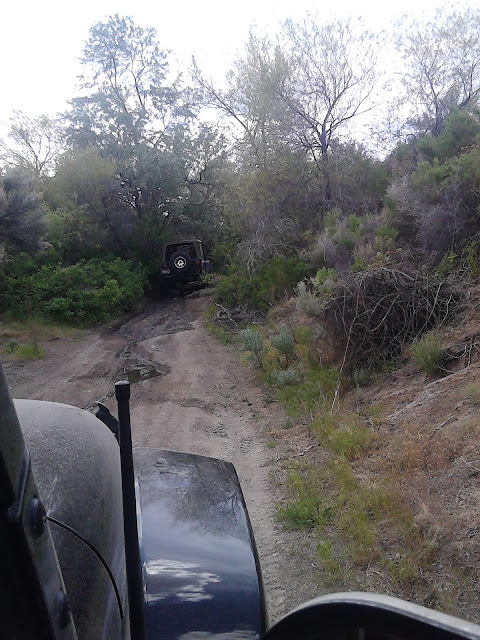

So Sunday I went out to a new trail. The trail was AMAZING with a ton of really fun obstacles. Unfortunately I overheated before getting to do any of the really fun stuff. I decided just to park my rig and not risk breaking something in the heat and I rode shotgun with my buddy in his JKU. Since I helped pretty much do everything to his rig, I figure I'd share some pics here.
I have since bought the parts to fix my fan which should solve the overheating issue.
Pics!
So even though I didn't get to beat on my junk it was still an awesome day! Learning that trail and having an experienced guide to walk us through the obstacles was well worth it.

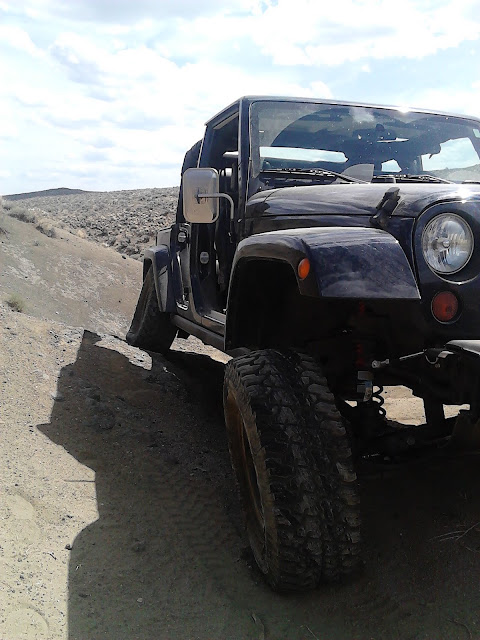

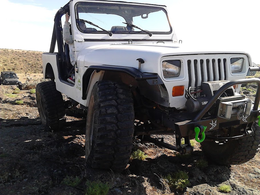

Took the Jeep out to play on the rocks for a bit today and to shoot some guns and bows and sh*t.
Had a nice passenger today
And some more
And some more pics...
And Justin taking the same line. My extra few inches of clearance over his set up made a difference here. He dragged his belly a few times...
