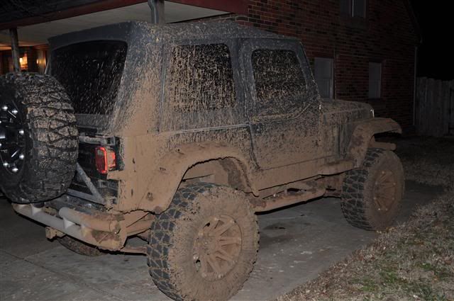

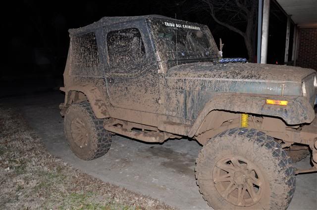

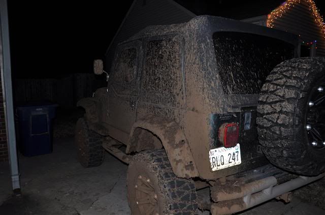

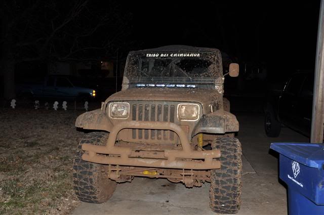

Took the Jeep out last night and hit some mud and water. Didn't think too much of the the water until it was coming over the hood. Well....started to run like crap after that. It would start and stay running (good news) but once I put in gear to drive off it died (bad news). Once I got it home, it seamed to run a little smoother....still have not driven it yet. I am planning on a new air filter, oil change, and plugs before going for a drive. Does this sound like it should fix the rough engine and popping that was not there before the water. Thanks for the help. Here are a couple pics of the Jeep when I got it home.
