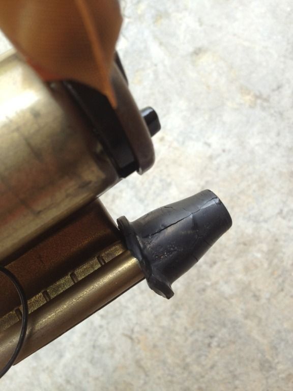

Something's definitely weird. Dropped the tank pulled the lines - they are fine!
Looked at the fuel pump, blocked on the return of course.
Now whats strange is that i didn't see anything in there thr could have blocked it. I tried to put it back and see what the deal is. The pump drops all the way with space about 1/16in up top where it bolts to the tank. I had to press it down to get the bolts going.
Another thing is the rubber piece on the bottom of the return line - it's cracked good bit like u can see onthe pic below.
I have not dipped in there to feel the blastic piece at the bottom of the tank but it seems ok. The only thing i can think of is the tank has somehow deformed maybe ie collapsed and the vertican height in the middle is now less ????
Anyway will need to dip in and see how that plastic piece is doing...
Know how far up the rubber end piece is supposed to go on the steel return line? I see a groove that leaves 1/8 in till the pipe. Wonder if it needs to go further up though...

I think that rubber peice is just there to keep the metal line from rubbing a hole in the tank.
Did you check the lines at the crossmember?
The one the lines go through before the tank.
If that line is sitting on the bottom of the tank it could be blocking it.
You could just drill a hole up higher than the end of the tube.
