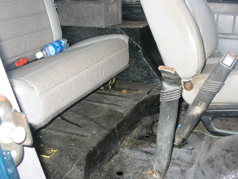

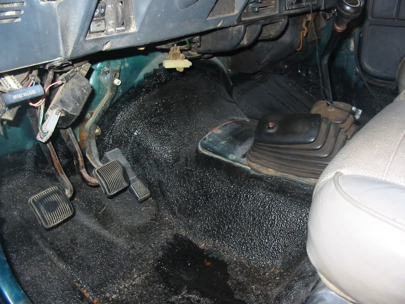

Here are some pics of what I have herculnied.
