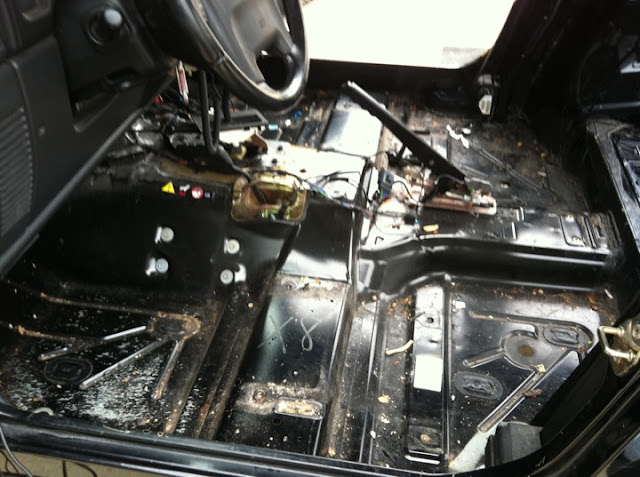

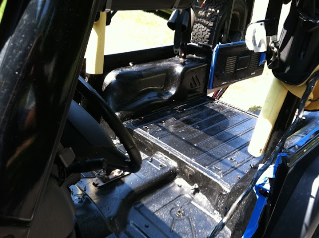

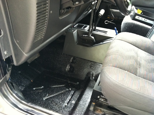

My Herc Job
Great Job! When I did mine I left the roll bars in and just meticulously painted around them....that and the owner before me had used some kind of liner in the corners and on top of the bases of the roll bar only so I couldn't get to the bolts. Here's what mine looks like from prep work to finish result. I had also bought a Tuffy center console and a new subwoofer so I installed those while I had the seat out...
