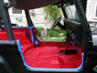

I did the inside of my tub yesterday. Here are a couple of pics about a 1/2 hour after the second coat.
