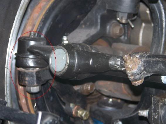

put the flip kit in, draglink hit the pitman arm at flex. put stock p-arm back on and it still hits a little. did i miss something? i drilled out the knuckles and draglink holes, welded the goferit sleeves in, bolted in, put stock p-arm on.

post #4 of 22 Old 07-08-2009, 05:44 PM Thread Starter

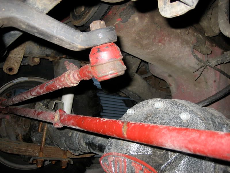

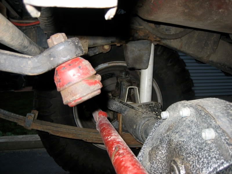

Here's a picture of my steering setup when I was making these changes a couple of years ago.
With the Gogerit flip kit, I needed to relocate the steering damper & track bar, but otherwise nothing else was in the way. Here's a picture of the drag-link to tie-rod connection - I can't see where you would get it to bind, maybe you could post a picture.
what did you do to relocate the trac bar? I see the raised bracket but how did you attach it? I want to get an adjustable one but the trac bar bolt is in the way, I thought about maybe trying to weld a bracket to it. I prefer the way it handled on the road with the trac bar.
