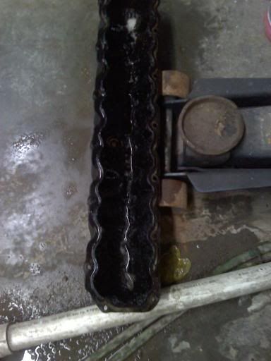

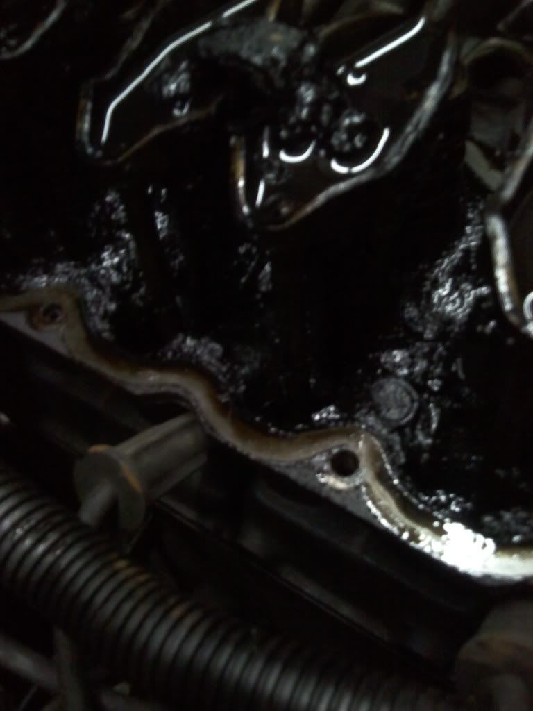

well just got the valve cover off...thta gunk is all in the motor too...what do i do? the valve cover was definitely covered..here is what i got...
the top pic shows only a fraction of the sludge..do i need to tear it down?

I would do one cause you dont know how clogged the passages are so i would at least do half oil half diesel in it to break it up run it for ten minutes then drain it and refill it prolly 5 or 6 times then it might be good but you dont know if its gonna be good or not

it runs strong so i mean it dont need a rebuild..and it has no blow by, but it is nasty inside...hate to tear it down right now...ive heard they get nasty but i just dont know how nasty..so i just drain half oil and put diesel fuel in the oil? is thta hard on it?

Block off the area the push rods come up through (passenger side) with some rags and go to town. Do you best to wire up as much as you can. Then hit the valve cover with oven cleaner or degreaser of choice. Remove the baffles and clean`em up.
Because of the sludge...............not uncommon...............the oil is "pooling" in the head/valve cover rather then draining back down to the pan. Another reason you are getting the blowby.
An oil change would be a good idea to help remove any gunk that may have fallen into the pan.
Then run it like you stole it, no worries..

thanks man..right now i am cleaning it out..took a screw driver and dug a chit ton of that stuff out..now taking a wire brush and diesel fuel..looking lots better..still gonna replace those parts too though
