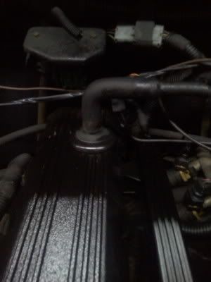

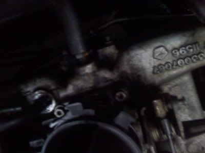

In order for the system to work properly..........and it will work................ All the lines need to be clean and free flowing. The part most miss is the baffles UNDER the valve cover.
You need to remove the valve cover and then remove the baffle plates. Clean them up good and reassemble. This question comes up often but most folks don`t know about the baffles in the CCV system.
Read this
http://www.jeepforum.com/forum/f12/v...stion-1097823/
Then there is a small orifice in the REAR breather elbow. that gets plugged.
http://www.jeepforum.com/forum/f310/...ite-up-733669/
Yes it is a bit of work but it will solve your oil problem and may provide a better running engine. Plus better vent control to your HVAC.
Post up if you have any other questions.

here is some pics of what the stuff looks liike..the plastic elbow things are broke, and it appears they have rigged hoses to make it work. Also there is a hose that appears to go to the brake booster..the hose barely hangs on..could this be my problem too..anyone have the part numbers to replace everything on the valve cover like the plastic fittings and tubes..any help is greatly appreciated thanks guys...its a 93 wrangler 4.0 if that helps
