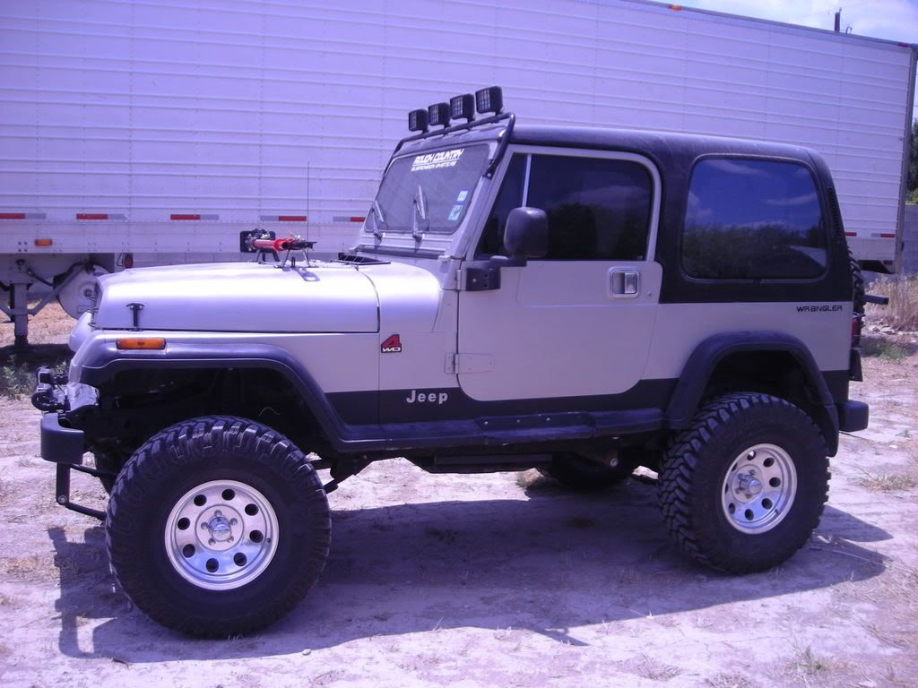

Well i have been the proud new owner of a Rough Country 4in lift for the last 3 months. All though it has saged 1/2in or so once the springs settled in it just stoped. I would recommened it to anybody who is looking for a lift on a budget.
Here are some pics of my DIRTY Jeep

BTW as you can see i have more than enough room for the 33s. Good luck

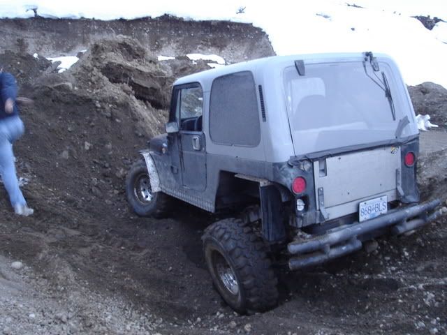

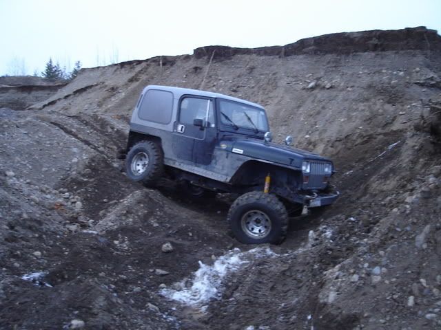

This is with a 3" BL and the 2.5" springs and cut fenders on 33 it is touching hte Dside fender and the pass side is maxed to the point of breaking a brake line and the shock is tapped out....
I used the heavy duty springs, been about 2 months now and no sag...even with TOP And Spare in teh back and all the gear......impressive springs.

Couple things I found, YES The tcase drop kit I needed, the angle was to bad without, you could get by, but I think and this is only my 2 cents, the drop kit is needed, brake lines, YES after doing it, the OME FLEX, and FLEX a lot, if my shocks were not taped out, I would have snapped a line for sure, os yes on those to, more to be safe then sorry. I also got a 3" BL, but that wont matter for angles.

Ya the springs a 2.5", I got prolly almost 4" lift, but my original springs were almost inverted.. ....with the shackles, It sits up almost 4" higher
now, I dont get hung up on crap that normalyy would botom me out, and the flex like I said all 4 stay on the ground...give me way better traction as well.
