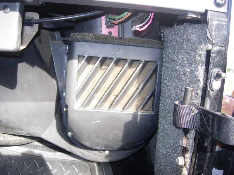

Originally Posted by Ferrick
Oops, yeah, I was talking about the foam as pictured, Jim. I hadn't looked into it but after reading this thread remembered noting that it was nasty dirty and could stand replacing.
Is there a consensus on whether or not it needs to be replaced?
It looks like it would be easy to take out and clean by removing the screws around the periphery of that housing. The hardest part would be prying it apart due to the sealer.
jim

True. I'd just be worried that the foam is so old it would dissentigrate under any sort of (water) pressure.
Might as well give it a shot in the coming days.
Isn't that foam directly applied to the door? I think it's so it dosen't rattle (like everything else on my YJ).

Originally Posted by Jim Piszar
I think Ferrick may be talking about the foam on the vent opening. I'm not sure if it is a filter or just a seal for the vent flap but, mine is pretty nasty too.
jim
Sorry for the delay on my own thread but here is what I found:
-Jeep runs for 5 minutes and temp guage is a 195-200 area and stays there
-vents up by window blow pretty warm air but not burning hot
-vents on floor are the same
-The vent pictured above is blowing in cold air faster then the warm air is coming in through the other vents. Anyone have any ideas?
If the vent pictured (fresh air vent) is blowing in while the heat is on, there's your problem. Mine closes when I slide the lever to heat. I'd check that first.
Jeffro06 is offline
post #54 of 60 Old 11-15-2007, 10:58 AM
timatoe
timatoe's Avatar
Posts: 15,813
True,,,that vent should be completely closed when the heater is running, and should not have forced air coming through ever (by forced I mean via the blower motor). The blower shouldn't run when the vent door's open is what I'm trying to say.
So in short that door is not functioning properly.

Posts: 252
outside air
Yea thats the outside air vent. On the right side is a lever try moving that with your fingers. I can visiually see it open and close. Open is letting outside air in. Someone correct me if I am wrong!
