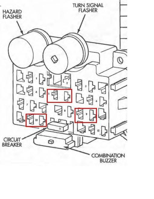

What fuses did you check?
These are all of the main interior lighting/radio/gauge fuses.
Edit: Check #8 as well.

Thanks guys! Yeah I only checked the dash light fuse. I'll have to go back and check them all. I hate checking fuses though haha they're such a pain to deal with when they're way up behind the dash like that

The plugs are notorious as is the circuit trace(s) on the gauges. As for the checking the fuses, a test light is ideal. IIRC there are 2 maybe 3 fuses that are hot all the time, the rest are on the ignition. As they are easier to check and also are prone to corrosion, check them first. I hope you have a garage. You can always ship it down here. Water is a bit cool 73 F, and it gets down to the low '80's at night. I'm just telling you this to make you feel better as the Arctic Express high balls it through. Spring is just around the corner and you'll have maybe 18 hrs of light to fix stuff.
