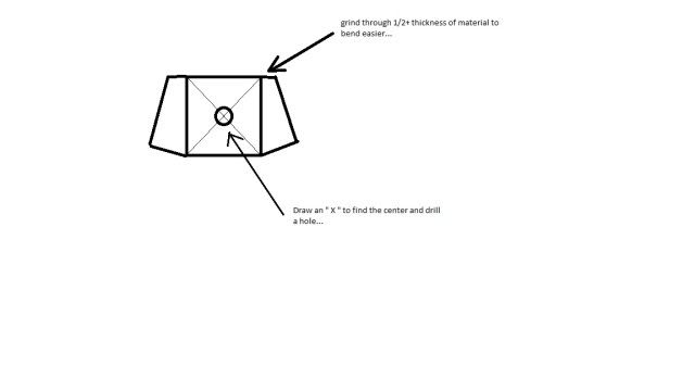

Posts: 562
SeanWilliams is offline

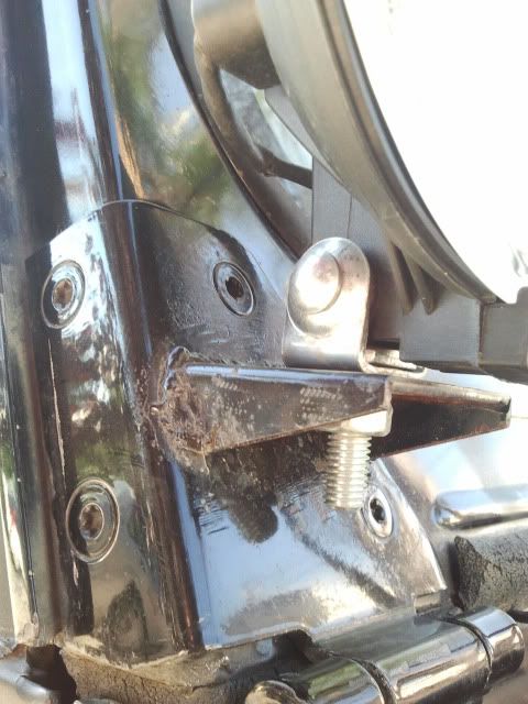

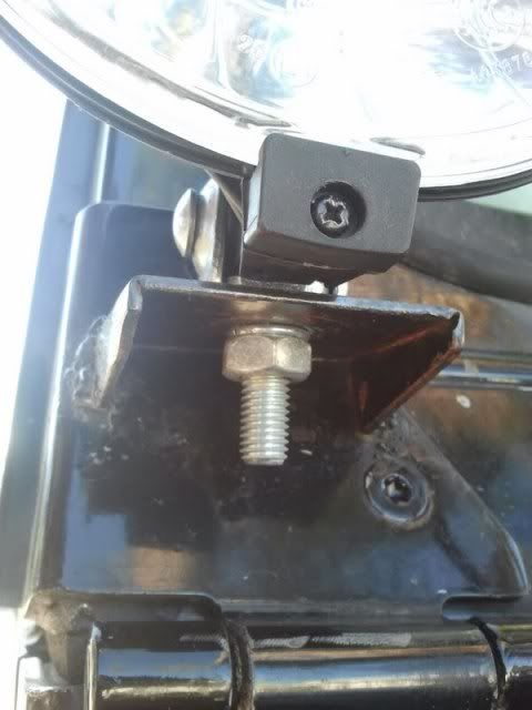

Here is a set I made...
