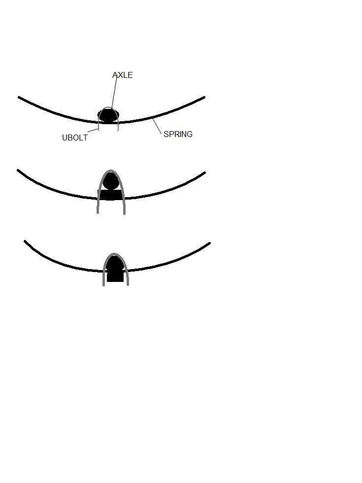

I get what you're saying - plate, block, spring, axle. That won't raise it any at all though, just push the plate down... since the spring's relation to the axle didn't change at all.

Draw it on paper & you'll easily see that it'll lower a stock SUA YJ.

hopefully this helps, there is no way to add blocks to a spring under vehicle to achieve a lift
