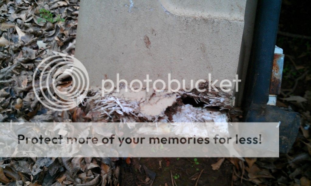

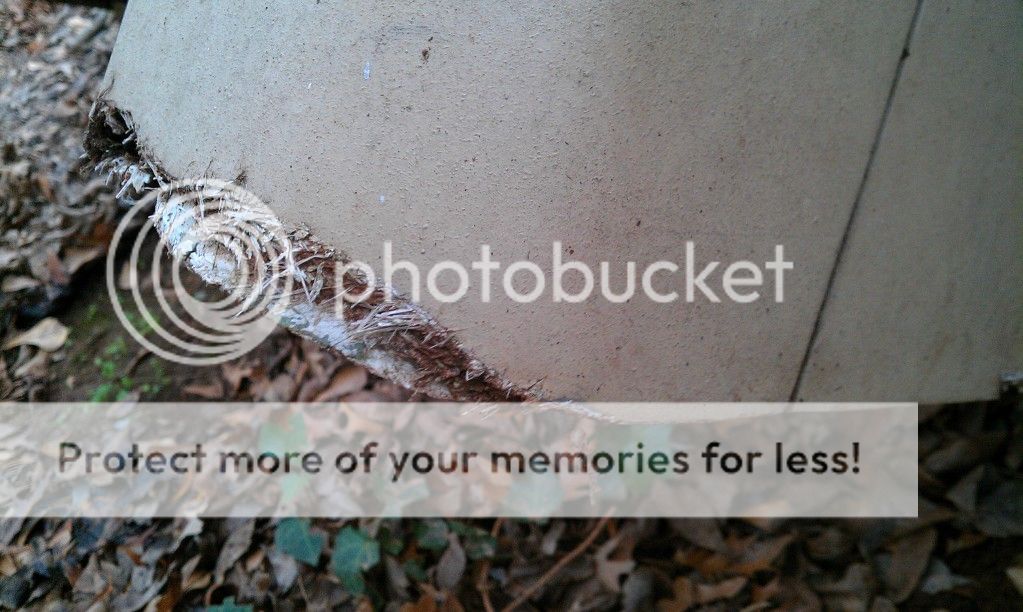

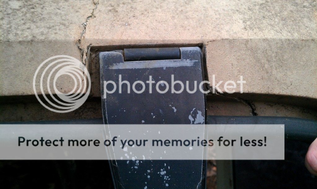

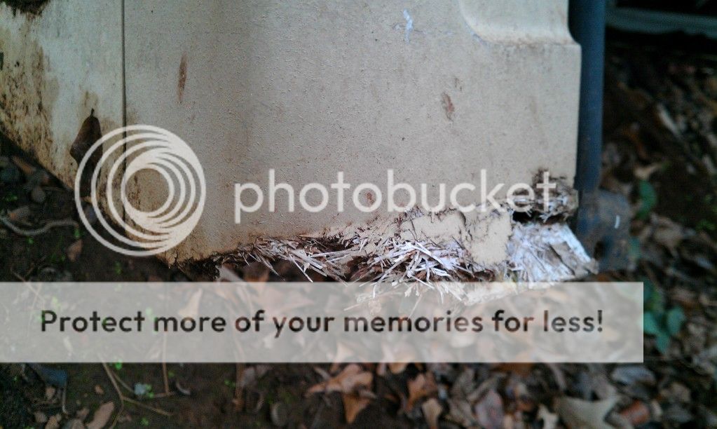

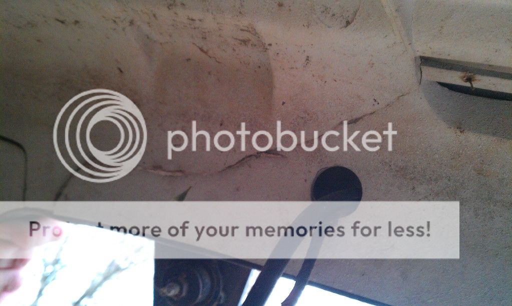

Ok so looking at buying this top. the guy is asking 100 bucks for it both rear corners need repair, and then there is a crack on the right rear hinge for the window. Other then the rest of the top it is sound. I have some experience in fiber glass, but I have never done any repairs. Does anyone have any experience in this, is this top repairable, how hard is it if so, etc, etc??

Wow, now that I am off work and on another computer, I can see the pics. I would pass on that sucker. It is tore up!!

That is more work than it looks, but it can be repaired. Even though the corners look the worst, they are probably the easiest to fix. It is that main crack I would go after first.
Without inspecting it on site, it appears the top may be out of square with that big a crack where it is, so the top has to be jiged up before repair is started, else it will never fit again.
If you are experienced in glass work, a lot of what I list will be common knowledge for you, but I will try to be thorough. Everyone has their own techniques, this is how I normally do it.
To jig it up, just install it on your jeep, and bolt it down solid. Male sure things look good at this point, if something is out of alignment, you may have to cut into the crack with a sawsall or jig saw to relieve stress.
Once it is the shape you want, start to repair the outside of the crack.
You have to have power grinders and power sanders, hand sanding and cutting will not work for this.
On the cracks, stop drill the end of each crack, 3/16 or 1/4 inch drill bit is what I would likely use. Then measure the thickness of the material. If you will be repairing both sides (inside and outside) divide thickness in half. Then go 10 to 1 on the thickness of the repair. This means if the top is 1/2 inch thick, and a 2 sided repair, go 10/4 inches on either side of the crack (2 1/2 inches) and beyond the end where stop drilled. You will sand an area 5 inches wide with the crack in the middle of the sanded area. You V-taper the sanded area with the crack in the base of the V (think make it kook like a valley). You don't want to sand all the way through and open the crack wider, just go half way with the deepest part. 40 grit and 80 grit open grit paper is what you will be using here on your sander. Do not try to smooth out the area like you would for paint, rough is good.
As mentioned above, epoxy resin is best for this type repair.
I prefer to use glass cloth, bi-directional weave, it is the most common weave unless you are ordering from an aircraft supply house. A decent repair can also be done with roving mat, I have used both and always opt for the cloth if I can get it.
Get a good, sharp pair of scissors (dollar store, $1 !). Get some Dacron tape if you can find it (I keep a roll of 2" always in my tool box). Also called peel-ply or sail cloth. Any good fiberglass supplier will have it. Also about a dozen 2" natural brisle brushes (lowes or WallyWorld, a buck each) . And some non wax-coated mixing containers about 1 pint in size each.
Now cut a strip of fiberglass cloth to run the length of the crack. Cut it 1" wide and orient the weave 45 degrees to the crack. Next cut a larger strip that still centers on the crack and is 2" wide or so. Orient the weave so it is 90 degrees to the crack. Keep cutting wider pieces of fiberglass each with the weave laying different from the previous piece. Trial fit this stuff dry, and it will be like a slinky, trying to pull all out of shape.
Remove your fiberglass strips and place them on clean pieces of news paper. Space them out so you can keep them straight.

To repair the inside part of the crack, I would turn the top up side down and work on it like that. The outside repair should hold everything in alignment while working on the inside.
Alternately, a piece of sheetmetal can be used for the inside part of the repair. You still do some glass work, just embed a sheetmetal patch to bridge the cracked area, using pop rivets to hold the sheetmetal in place. The top may not be thick enough for this, or the sheetmetal patch may be unsuitable for where your crack is.
Either way, a total glass repair should be your first choice.
If you can, post some pics of the corner damage from further back so I can see more where and what is damaged.

Thanks old4x! So great info. What about the corners? I am about to go pick the top up, the guy js lowered his price to 50 bucks. Also how much do you think it will cost to repair this crack and corners?

Repair cost for materials and some paint, $250 should cover it.
The corners can just be built up using a piece of plastic on one side (cut the side off an antifreeze bottle or similar ) as a form and build it up oversize using roving mat and resin. Let set up and sand and file to the desired contour. Easy job.
Alternately you can do it while the top is installed on the Jeep. Cover the body surfaces with duct tape and mask all adjoining surfaces (especially anything below your work area). Paste wax the duct tape just to be sure the resin releases. Then fill in the missing area with roving mat and resin, you may have to put a backer on the inside to keep things in place (plastic here again). You may have to oversand the repair after it sets up and cover with 2 layers of saturated glass cloth and the peel-ply thing to get the final look you want.
Once set up, remove the top and clean up the repair, sanding to final contour. Prime and paint.
