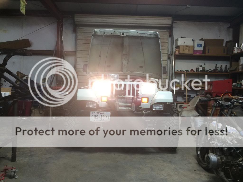

This thread has kinda went to HID and LED but I installed the conversions tonight. I went with the rugged ridge kit
Driver side is the sealed beam passenger side is the H4
Wish I would have gotten better before pics didn't really think about it as far as an upgrade I don't think it could have gotten any easier and the results were night and day (sorry for the pun) I'm going to have to adjust the drivers side a little
