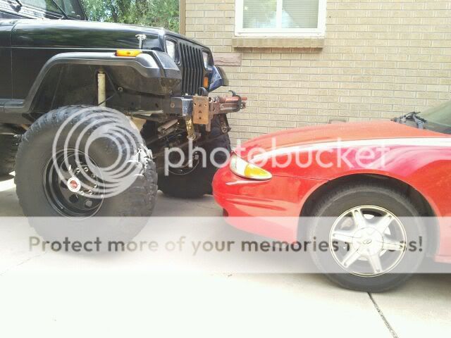

i could see why he want to lower it. it has all most 10in of lift

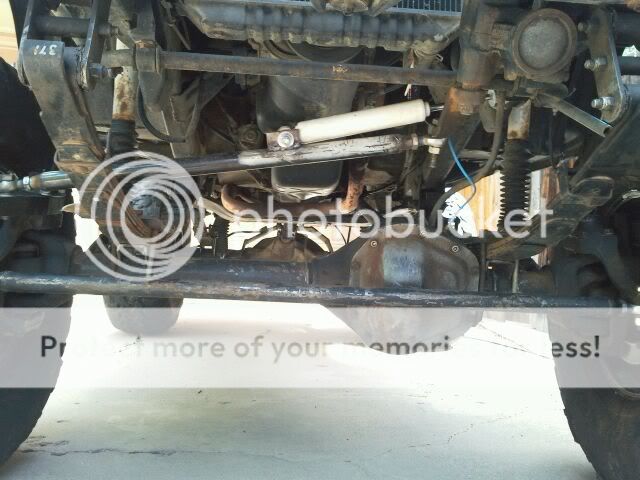

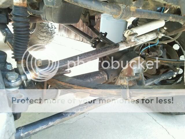

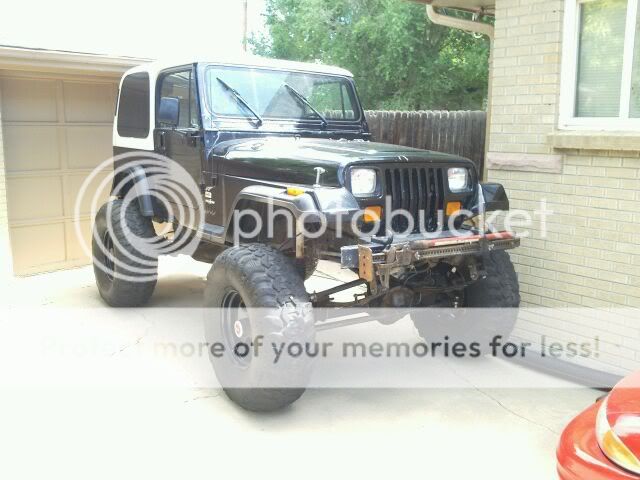

Some pics
[IMG][/IMG]
[IMG][/IMG]
[IMG][/IMG]
[IMG][/IMG]

Looks good. But might want to check your caster, that pinion looks like it was rotated up too much.

i like it =)

If it was me in that boat..i'd go SUA since that front axle looks like the pinion angle is way off,youre going have to cut the spring brackets off and move anyhow.
