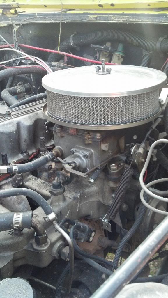

Im running a Motorcraft 2100 off an old mustang and it works wonders better than the old carter the only difficulties i had with it was finding bigger sized jets for it. and i just ordered an adaptor from speedway to get it to fit

Motorcraft is amazing offroad. I've sat at some crazy angles idling for 5-10 min, no problem.. Got me home on 4.8v before also! Alternator slowly died..
I did nutter bypass along with ignition upgrade and deleted all but 3 vacuum lines
