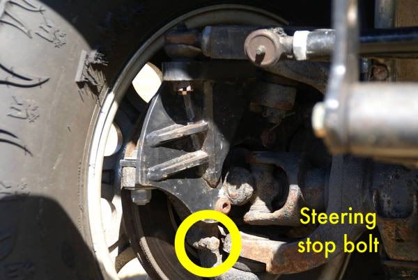

Here's a visual aid for others who may read this thread.
For the steering stop, there's a bolt with a nut on it. The nut is actually welded onto the bolt, but you can just remove the bolt & nut all at once & shim it out with a washer (or washers) to get the steering to stop prior to rubbing.
