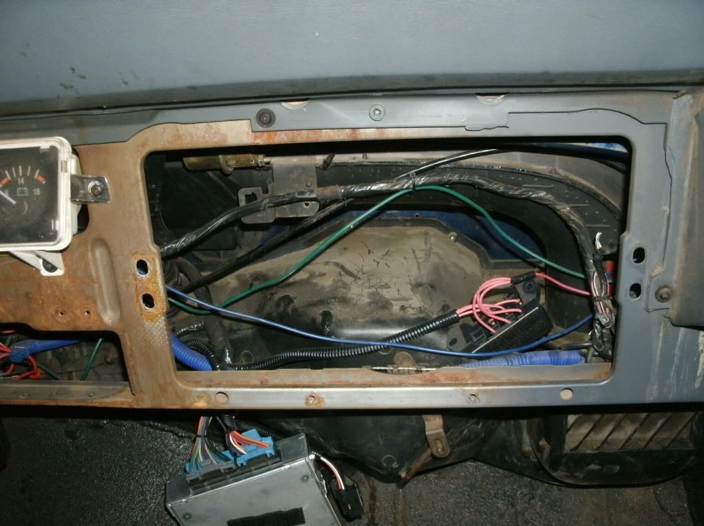

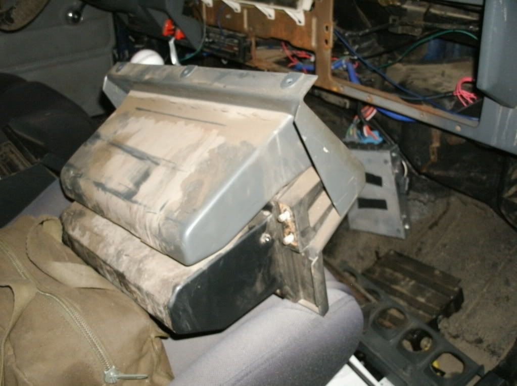

Mine also had nuts. It obviously is different at some point by year. Here's some pics of mine out, maybe that will help you. The screws will be in the same spots as the bolt studs if that's what you've got.
Nevermind my mess of wires back there. lol

Hahaha thanks for the help, I knew there had to be something big holding it on cause i was really pulling hard! good thing i didn't bust it off lol I'll have to go check mine out tonight, i'll let you know what kind of fasteners i find.. thanks!
