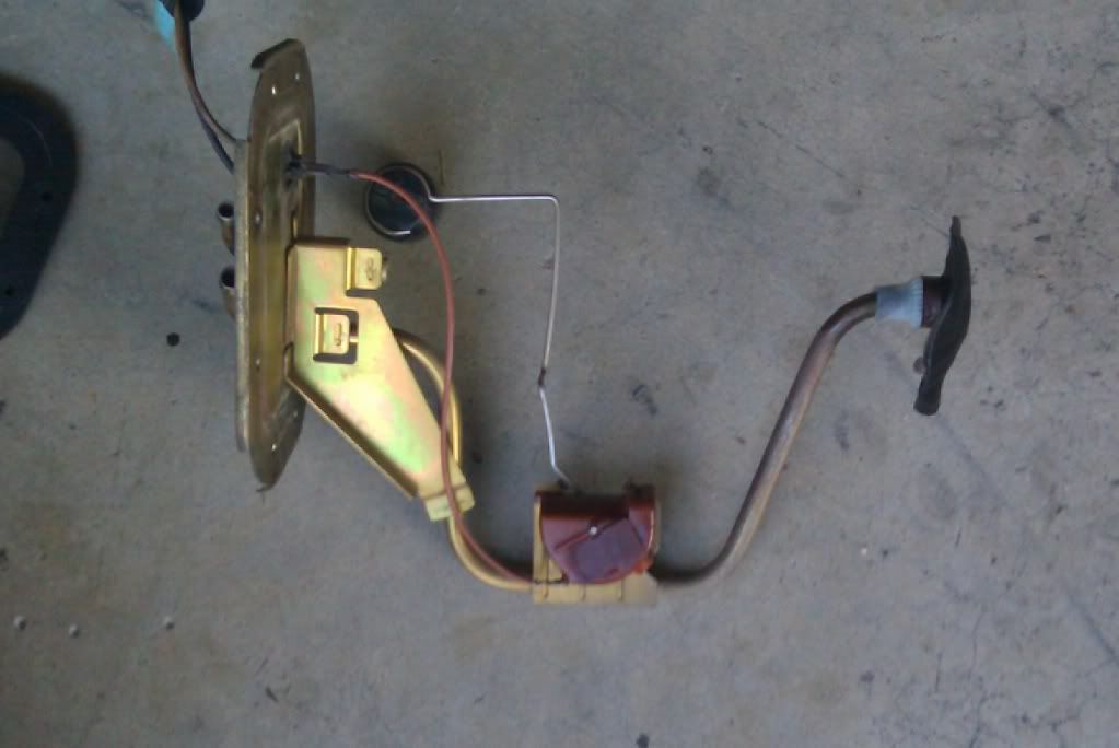

Actually now that I have it in my hands what I got was the fuel injected one without the pump. It also doesnt come with a gasket.. how nice. On top of that the electrical plugs are different so I'll have to clip the original plug off the old one and splice it into the new one.
lineman339 had it right... The tank size diff Mark05059 talks about is when the fuel enjection first started like 90 to 94.

no I talked with the qtec guy. the other one listed is discontinued... There are 2 tanks round is 15 square is 20. Since the old sender is discontinued you have to modify slightly the one I linked. Dont forget to order the gasket too.

I tested the sender and the resistance in the units are the same. All you have to do is solder the wires together. There are three on the new one ignore the orange wire its for the fuel pump which you dont have. Just the brown and black need to be soldered. Cut the old plug off and leave about 6 inches of wire on the plug. Cut the new plug off close to the plug this should leave you with a little extra wire. Strip the insulation off the wires and solder the old plug onto the new harness. Wrap with electrical tape.

As I undersand it as the gas tanks go... From 87 thru 90 there are 2 one is 20 with a square sender and one is 15 with a round sender. In 91 they went to just the 20 gal tank with the square sender and used the longer vent tube to make it a 15 gal. Those were all fule injected so the sender also had a fuel pump attached.
The sender I sent the link to is the 91 and newer sender but they leave the fuel pump off. Since its a newer type sender it also has a diff connector on it that you have to cut off and splice on the old connector from the original.

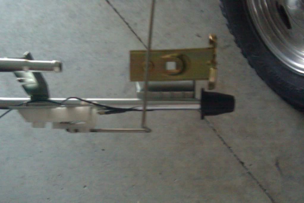

guess what just showed up at my door? Re-reading your post... you have a square opening tank. Yes it is a stock 20 gallon tank. it needs the sender that I linked up in an earlier post.
This is the same pickup I used. I just added to the pickup side of the pump. The return side is OK the way it is. I used a fuel line and clamped it to the pickup. Made sure it was long enough to reach the bottom and zip tied it to the bracket. Been working fine..... As for the wires I don't use my gauges. "All autometer"
