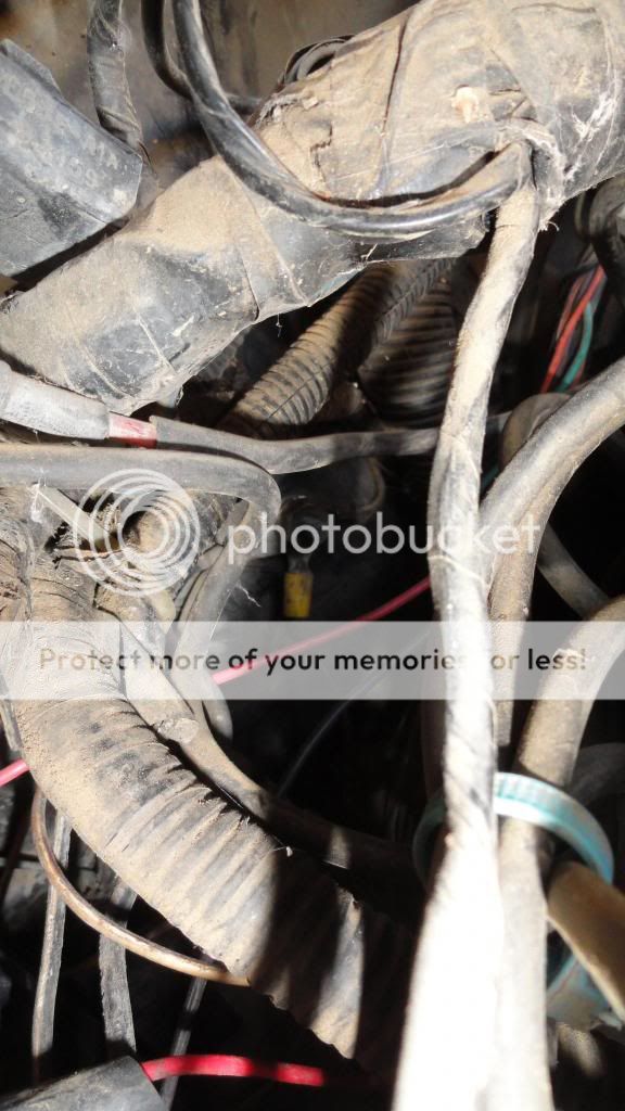

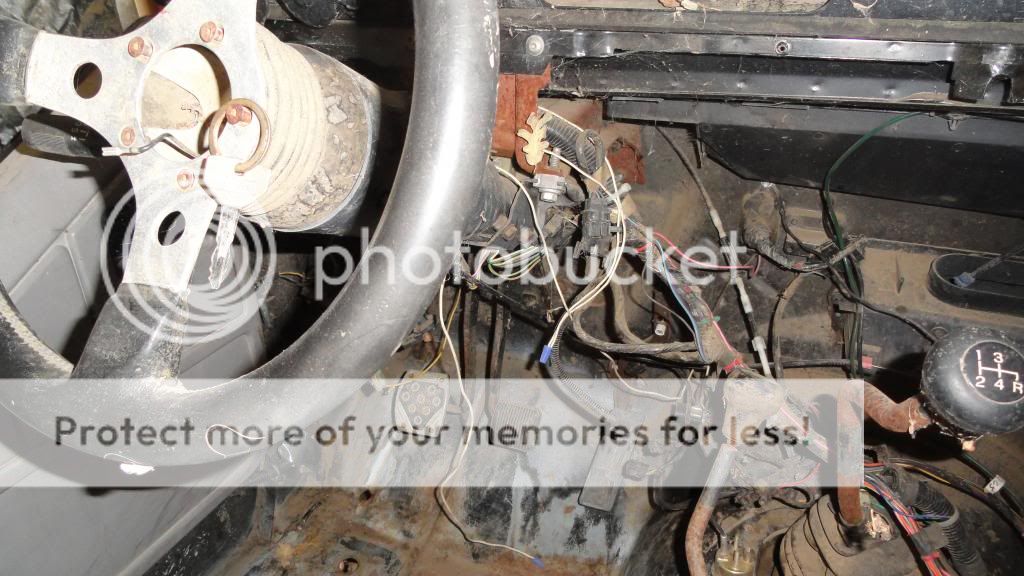

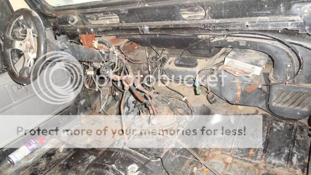

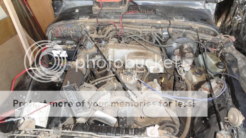

okay, starting off, this is my engine compartment,
here is all the stuff
and this is the current condition of my interior-
please not, unless i say otherwise, during all testing,
this is the current position of the key
and in case there are any questions about the quality of this job,
this is under my battery...
flipit is offline

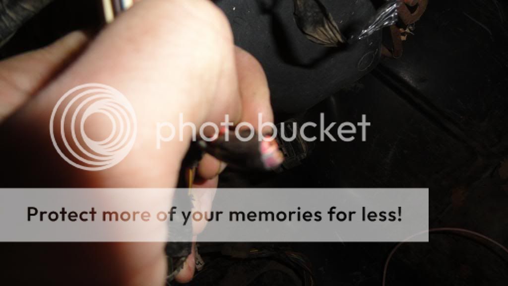

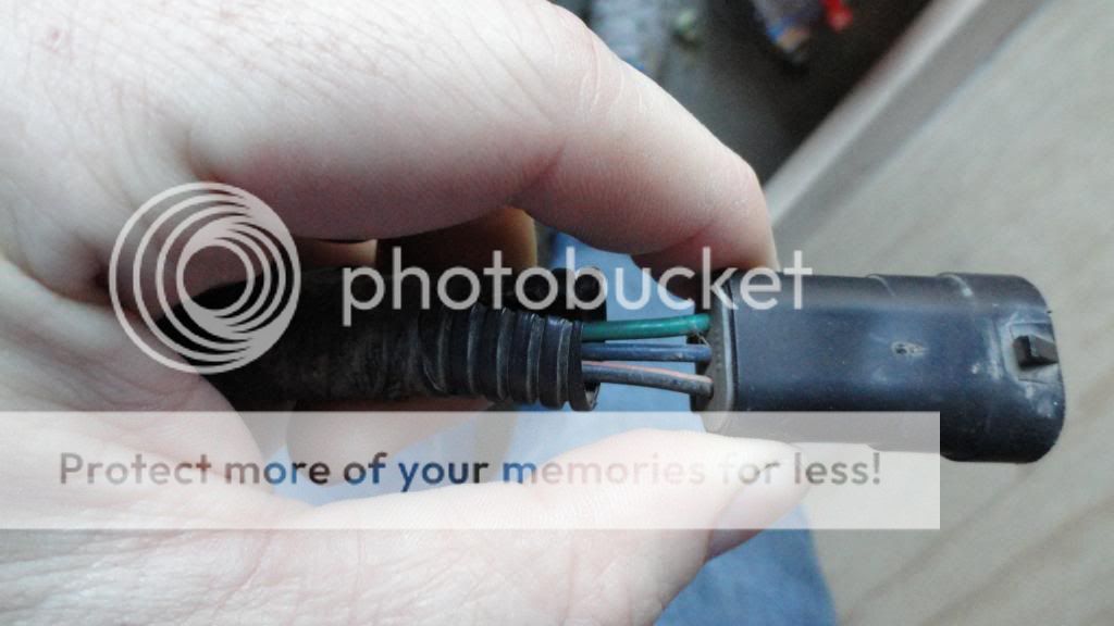

okay, for this journey,
I'm going to start it off nice and easy-

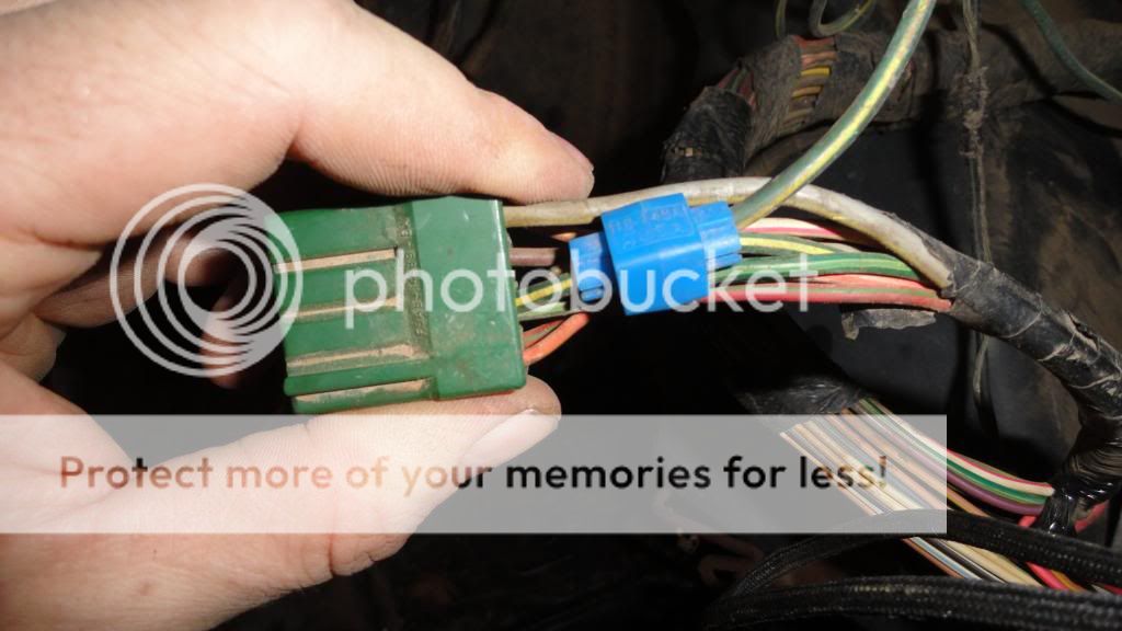

these three wires connect to the fuel pump connector-
now, from bottom to top-
the ground wire,
note the color, black, with an orange stripe,
goes into the bay, and is screwed into the firewall here.
not the yellow crimp, kinda hard to see i know-
if there's a break in this wire, It touches another grounding point,
cause to the best of my knowledge this line works as advertised.
next up is the gauge,
most of the way up the line,
he cut the dark blue cable and spliced it,
then re spliced it at the end,
shown by the following pictures...
this line as well,
when the jeep started up, the tank was always 1/4 tank high, but it did work.

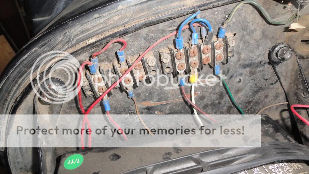

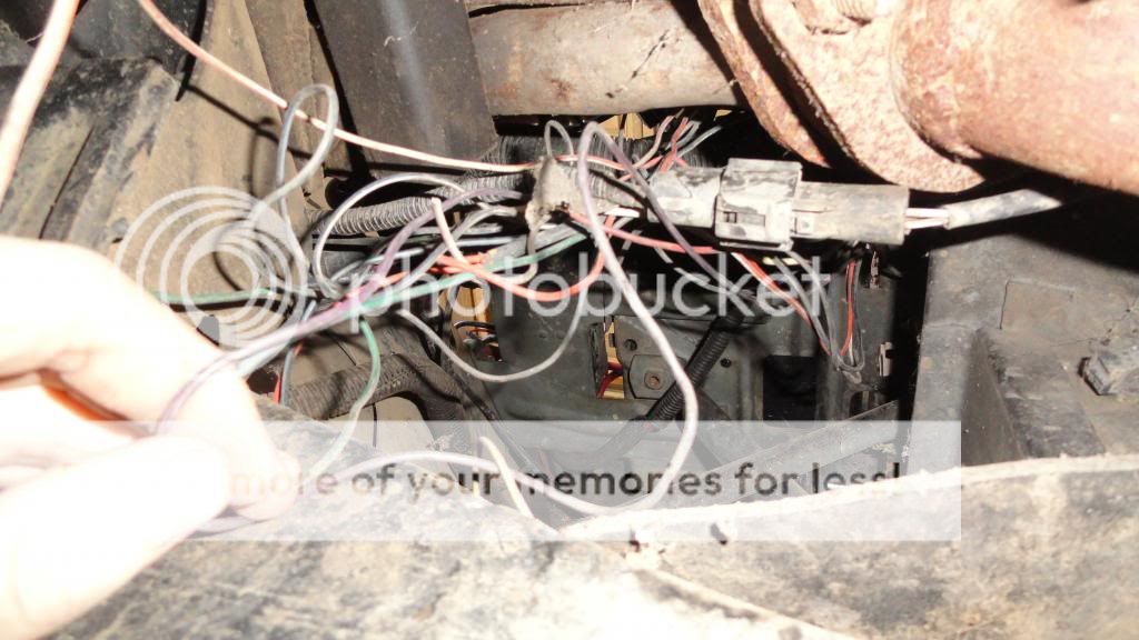

now for the painful wire,
dk grn/blk...
that cable makes a snug, straight shot here-
bottom right of terminal board-
then,
top right,
green/yellow, goes into here..
the excess is zipped tied,
and the end is add-a-spliced here.

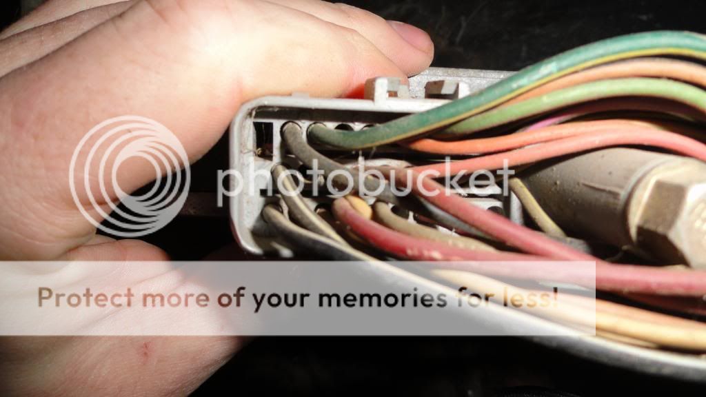

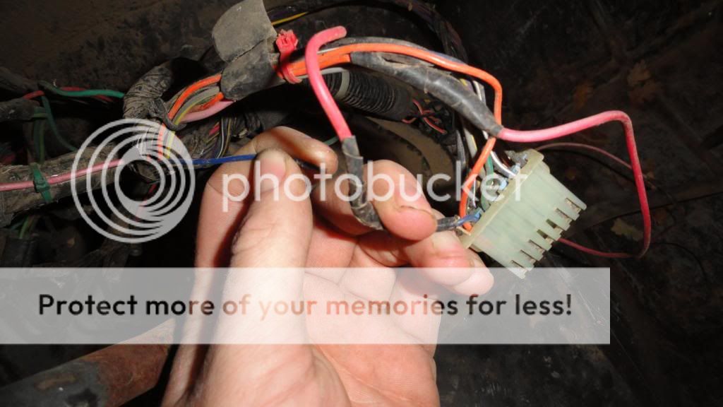

if you follow the stock green/yellow, it is pinned on one side via the connector,
and the other goes into pin 19 of the ECU...

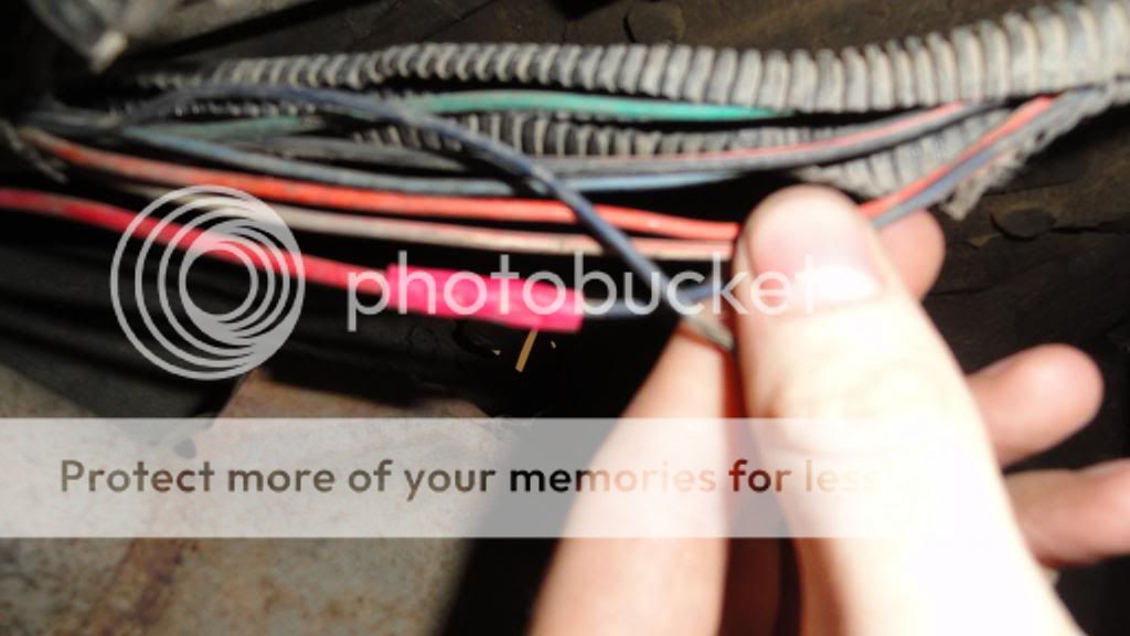

while undoing the wiring harness i found these two open wires...
and this guy is pin 22.
