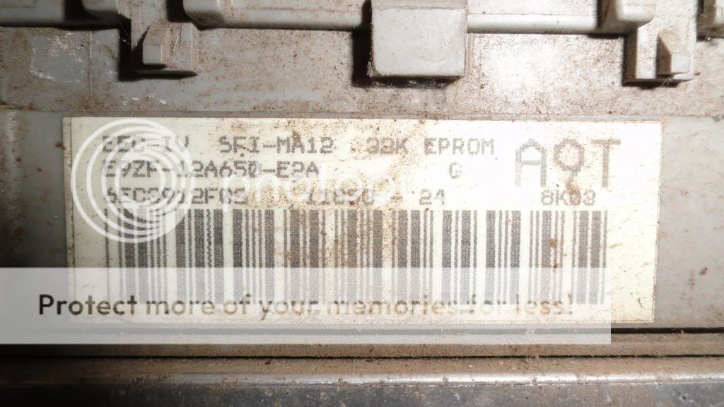

This is my ECU...

From what I can find that ECU is for a 1989 -to early 90's possibly 1993 5.0 w/automatic tranny
Do you know what was good about the good old days? I wasn't good, And I wasn't old!
this is on the wiring harness, not sure if it helps or not
also, just in case this was missed... My tranny is a borg warner manual.
