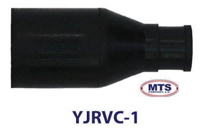

So, I have this problem where fuel dumps out of the passenger rear fender when I have the Jeep angled uphill (as in, any time I am climbing anything). With fuel as expensive as it is, I would get this fixed...of course, the safety issue is pretty significant too.
I dropped my gas tank today for some work and discovered this just sitting (unconnected) on top of my gas tank:
What you are looking at is a rubber sleeve thingy that connects the rollover valve to a metal tube which later turns into rubber again right before it enters the tank. The rubber sleeve is broken, so any gas that spilled/sloshed out the top of the metal tube was just running right out the fender. This is an image looking up into the fender where you can see the top of the metal tube and the rest of the rubber sleeve that is still held on with a hose clamp:
I looked around online and this looks like it might be a replacement for the rubber part: Rollover valve "connector"
Here's another one that is probably almost certianly the right part. It is part number YJRVC-1 at: http://www.mtscompany.com/miscjeep.htm and here is what it looks like:

I replaced mine with one from Chrysler, they had it in stock.

So, since there is no dealer nearby, I went ahead and called up MTS. They are shipping me the part priority mail for $19 ($13 for the part + $5 for shipping) and supposedly it should be here later this week. Apparently they don't advertise prices online since they are a wholesaler and usually sell only to local distributors. Keeping my finger's crossed.
