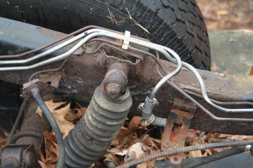

Setting up to run the lines (fuel/brake) along the frame rail and don't have a good picture of the routing especially around the shock tower to the Tank. If anyone has a good picture of these lines I would greatly appreciate it. TIA Jim

here are some I snapped of my rusty parts Jeep...hope they help

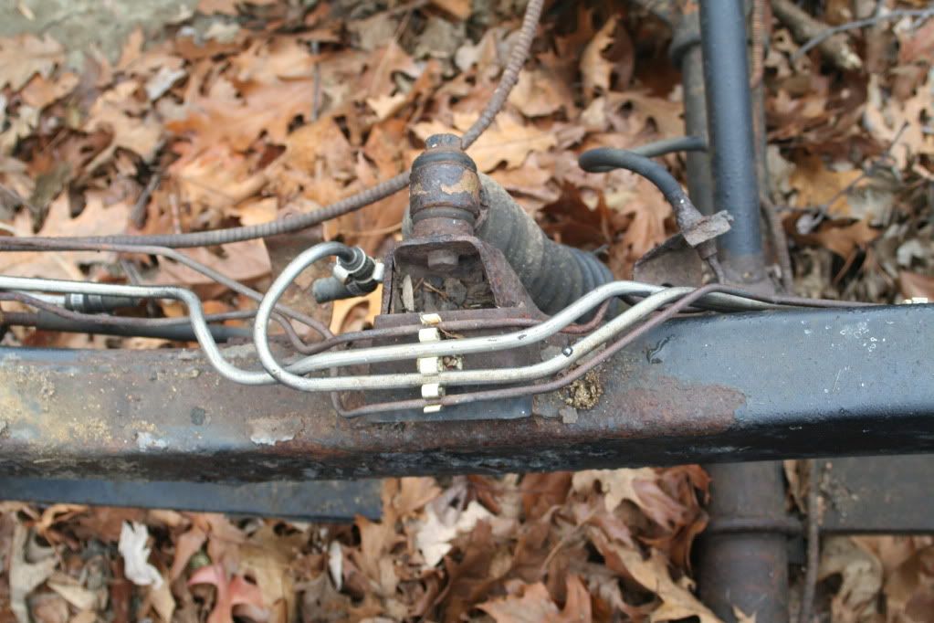

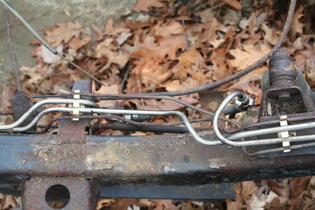

Thank you that helps alot. Any chance I can trouble you for one more of the other side of the fuel lines were the come through that protective plastic cap?? Thanks again.
do you mean where they go through that black rubber block that protects them at the crossmember?
if so I can snap a pic tomorrow in the daylight... but be aware they won't be connected to anything, as the whole assy. is now just laying out by my shed

no sunshine today, but snapped a couple of quick pics for ya'

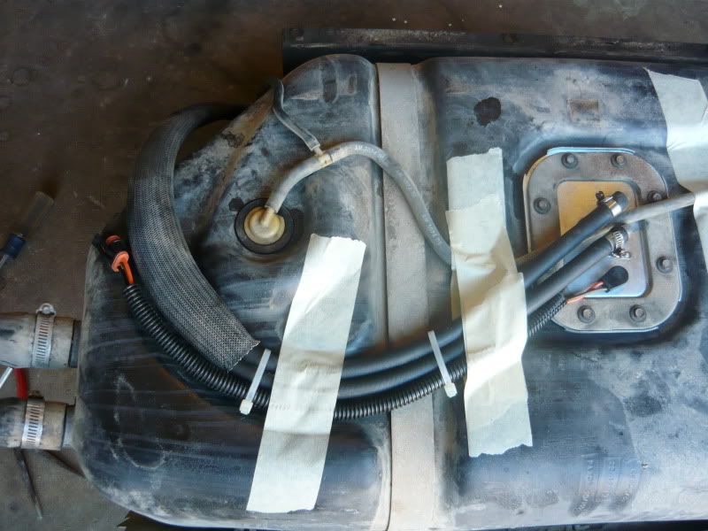

Here's how I tape the lines & wiring in place to avoid pinching.
Otherwise, you can end up with a pinched fuel line like this in one of my customer's Jeep.
