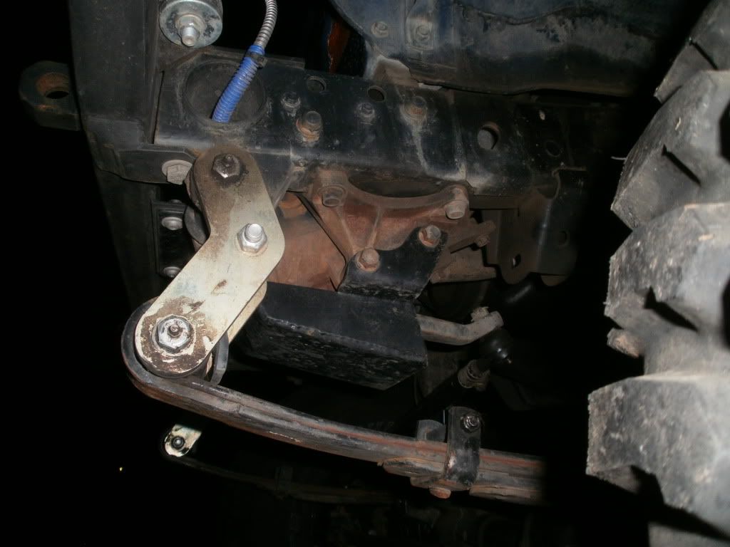

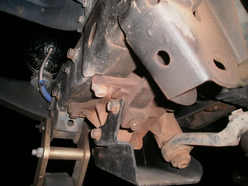

Yeah I get what your saying, but are you listening to what I'm sayin?
I'm not looking for a suspension education session here, or i would have asked if i should use it or not and why. I appreciate your advise on not using the track bar but that's not the reason I put this post up. I was only looking for someone to offer some input on where the bracket was located, not if it should have been there in the first place.

If you look at the axle disconnect, there is a bracket on the front of the axle were the tracbar attaches, right above the steering stabilizer. Bolt on eye of your tracbar to this bracket, now you want your tracbar to be the same angle as your draglink from the steering box to the right side of the axle. You will need to fab a bracket since the tracbar will be to short with a SOA.
I know you like the tracbar, but after replacing all of your fillings, chard loose by the rough ride you most likely will remove it.

See this bracket behind the steering box? Yep, that's where it went stock.
Doesn't matter where you put an aftermarket one on the frame.

As stated, the track bar really is not needed but it's your choice if you want it or not.
Here are the locations.

Thanks for the detailed locations of the bar mounts. When the PO did the frame repair and soa he made some interesting decisions when it came to how modify things. You should have seen the cherokee rear sway bar he had half *** welded in under the front end.
This jeep won't see too much offroad once its back together completely. My next debate is whether or not to buy standard or hd springs stock height springs, cuz the ones on here are starting to bend the other way and I want to get it sitting nice and level before I fab anything.
