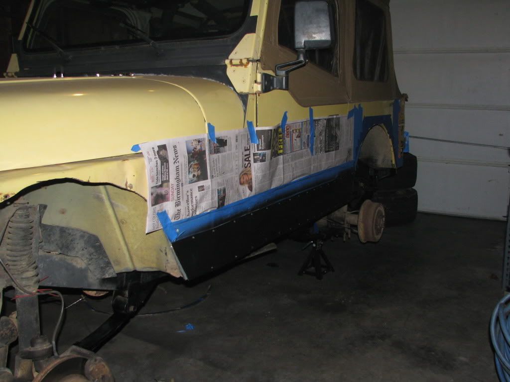

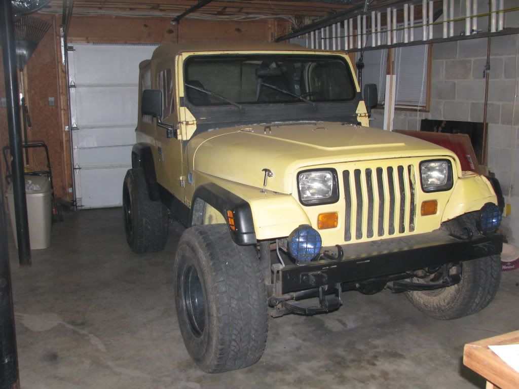

^This is what I used for reference did when I installed mine last week. Some motivation to get you started...

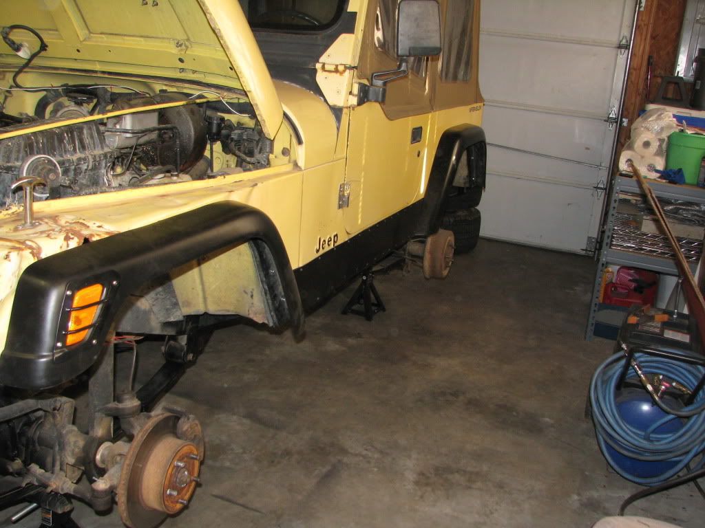

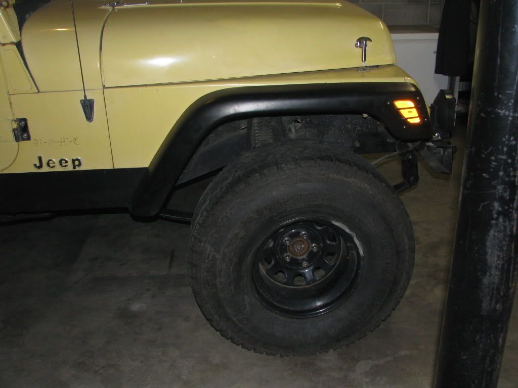

A couple more. You can see where I trimmed the front fender in the first photo

Thanks! I measured about 100 times and cut once.
