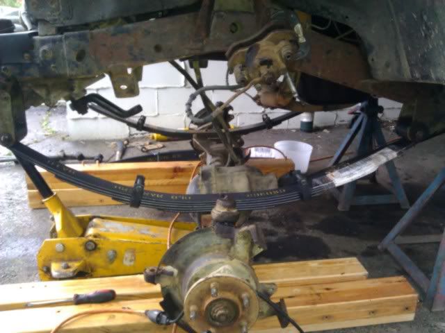

And so it begins... but will take a few days, gotta work the next 2 and got sundayoff....
spring swap first...

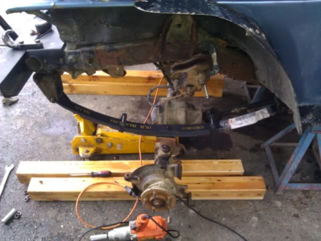

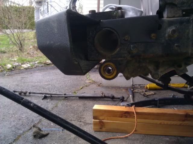

straigh up remove and replace... this was easy mostly... just had it apart last year so it came apatt in short order, new ubolts, reused the bushings, those were new last year.... love to say it was a ***** to get it apart, but yaaaa, no.... the bushings and everything just fell out....
for my app, the shims need to come out... so clamp the spring and remove the cneter pin.... remove the shim and bolt together again, for SOA you will have to cut the cneter bolt down as well...
for removal prettystraight up, remove the rear hanger bolt, I unbolted my 3 shackle bolts and jsut used myhands to pull them out of hte springs and hangers, and removed the springs.... reuse bushingsand sleeves... rebolt.
been lots of talk of this lately.......
OME makes 2 HD springs, when you ask for hte HD you will get the 14s..... the below pic, the dirty ones, are the 14, they area 4 pack.... the 36R is hte 5 pack... HD whcih I need for SOA... I reordered last year after I bent 2 and did not SPECIFY the 36, just HD,so I got the 14, they were already starting to invert SOA, the rear I have are 36, thiose are holding nice with SOA...
see the diffference.... 4 and 5.... #popcorn

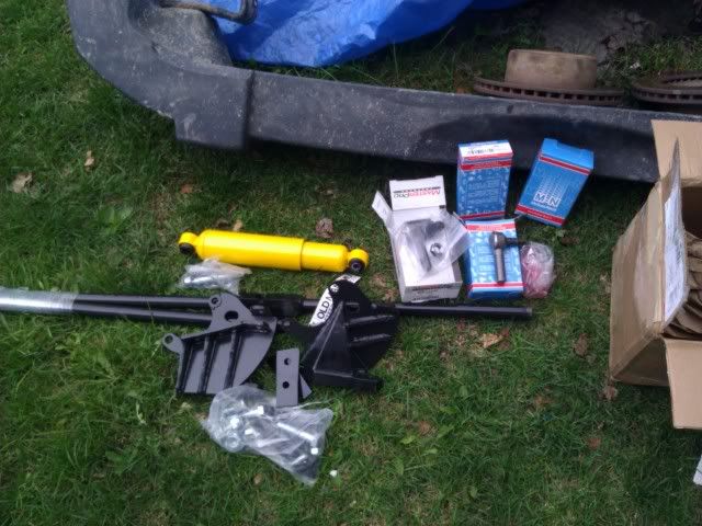

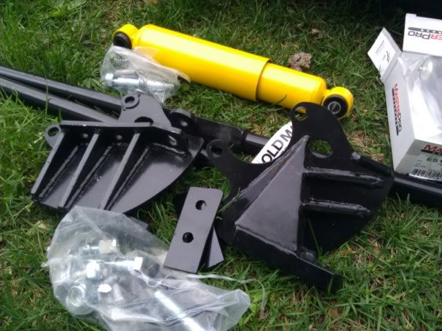

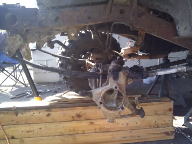

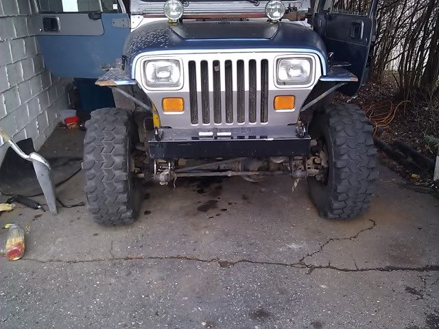

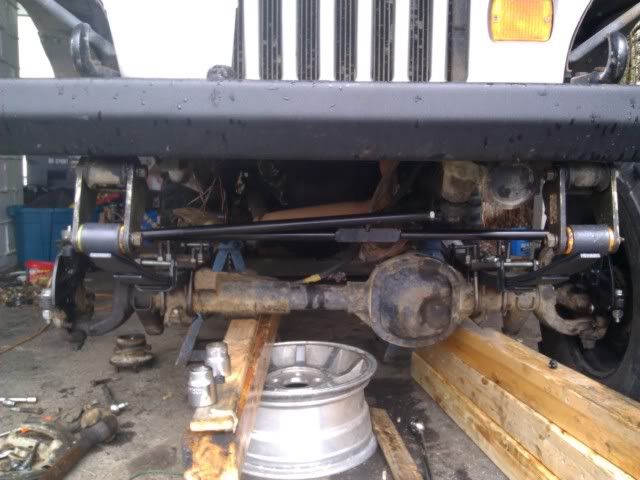

springs on and onto the actual OTT....
rofl

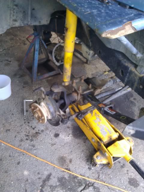

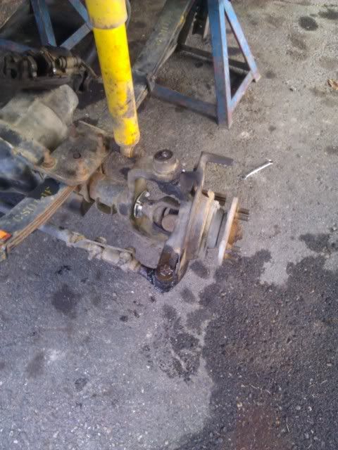

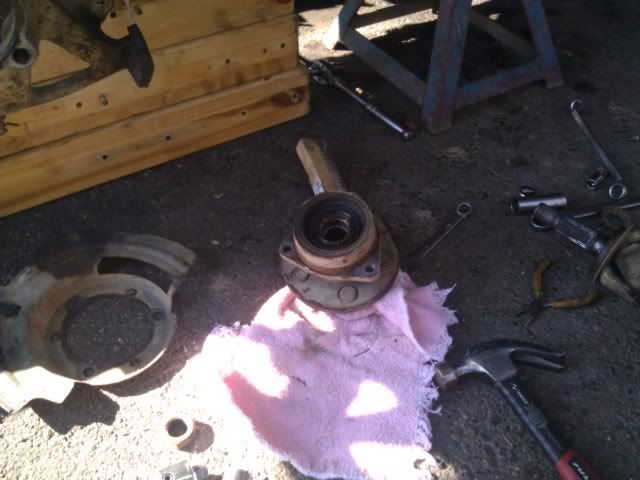

So where to start... well if you NOT swapping springs all you ned to do is remove your tire, caliper, and hub assembly.... the later being the hardest, again I just changed mydriver side ujoints and seals couple years ago so I started here... it came apart nice and easy, with the help of a 4 foot breaker bar....
steering and drag link removed...
you could do this now or after the actual mounting of the unit on the knuckle... dont really matter...
one advantage I will mention here to leaving you drag link and Sh$t on is there is a good writeup on here
somewhere of how to use a socket and the steerign to remove the hub assemblywithout beating on it with a hammer, I did this when I did myujoints but forgot about it till it came tiem to do hte beating part.... #****er

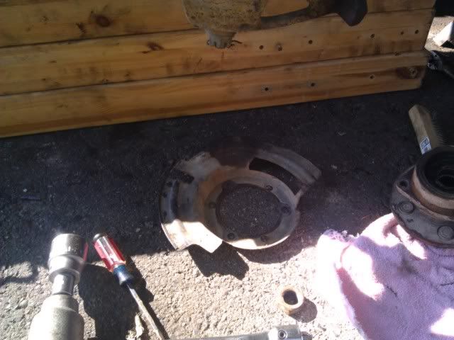

for the hub assembly, remove hte 3 bolts on the back side of the unit... mine was obviously changed out at one point.. I had 3 9/16 bolts on the pass side, and 13 mil, 12 point on the driver side.... either way the impact made short work of them....
anyhow it came off not so bad..

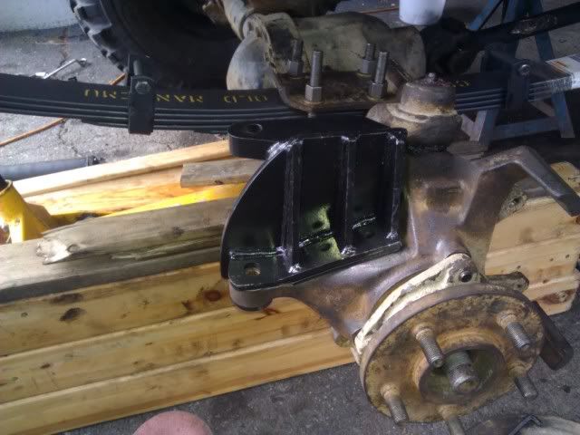

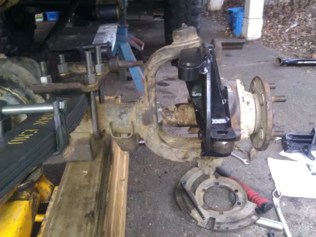

anyhow the whole point of this is to get the dust sheild off....
then test it out....

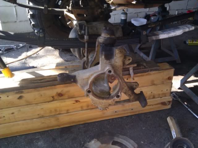

WTF. mine has a gap about 3 mil between the knuckle and the unit... but READ THE DISTRUCTIONS.... I was freaking out.... they give ya shims, I guess some wranglers vary in this department.... whew....
some grinding is involved here to smooth out the ridge on the knuckle....
got it grinded and snuged on the backside....
gotta drill ou the top and tap it... but its late Im beat, and thats all for today...

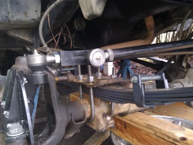

MORE DONE....

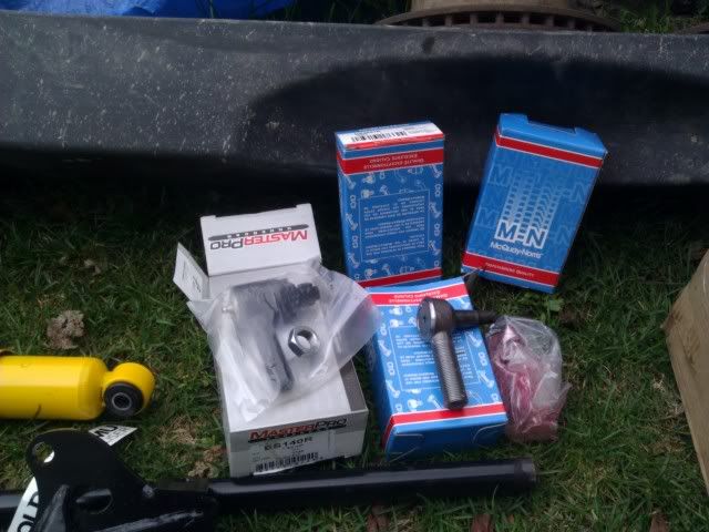

Got up to heeps place to help/watch Bones put his rig together.... mostly help, man I tell ya, go up to chit chat and ya get put to work.... #****er
anyhow, bones helped ME, slap my drg link together, and yesterday I got in mocked up and into place.... just all needs lock tite now and bolted back together.....
Well started to get it back together and got as far as putting the rotors and in my infinite wisdom I putthe dust sheilds on backwards
so ya, screw it Im done for the day.... man gotta rip the hub off again..... PAY ATTENTION......

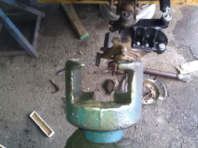

Oh read lots of threads of ppl breaking their pitman pullers, so I thought about going to buy one, but working at a dealership, I just whipped down there and borrowed their ginormous one.... no breaking this *****... and this was the 'small' one, we got one there for 5 tons and the like...

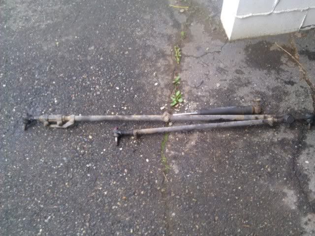

KINDA SEE HERE WHAT i USED TO HAVE....
Then after all this I get to replace a driver side axle seal, and replace my oil pan seal, and do the fluids, diffs,

well finally got it done yesterday.....
holy snikies, what a difference..... gotta get aalignment done yet, but wow... now when I turn the wheel it actually turns right away, instead of a delay... lol...
nice and tight... I still have to get over it in my mind that it is bolted on and its a 'trust' thing right now so its slow going, getting it welded on Sunday, but wanted to get a couple days driving in to let it all settle before I do that, then retorque everything and weld it up...
anyone with SOA or big lifts and no highsteer, do not post thread about bad handling until you do a highsteer. if you still have bad handling AFTER a highsteer then post... this is the cause of your **** handling for the most part.
mine is tight now, does NOT wander, and NO bumbsteer AT ALL.... like I said still needs an alignment but tracks pretty straight as it is
