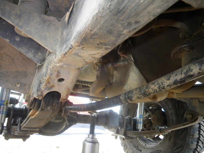

I'm gonna try making a new drive shaft out of old chromo axles.
jbolty is offline
That driveshaft looks like my stock tie rod.
All that pressure on the ujoints
