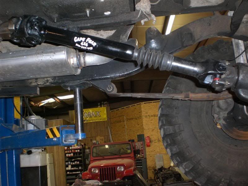

i've always seen driveshafts made by grinding off the welds on the yoke side, hammering the yoke off after getting down far enough, then chopping it, making sure it's straight, then spinning it on roller bearings to make sure everything spins true... tack it 180 apart, spin it again to see if it's straight. then tack it more. spin it... then just spin it while holding the welder steady all the way across. never seen one break and comes out alot cleaner looking too, looks factory.

my home made shaft looks oem
the cv half is from an XJ front, the splines and yoke on the other end were left over from a front TJ shaft.

That is a nicely done shaft there, it actually looks better than you would expect from the OEM
