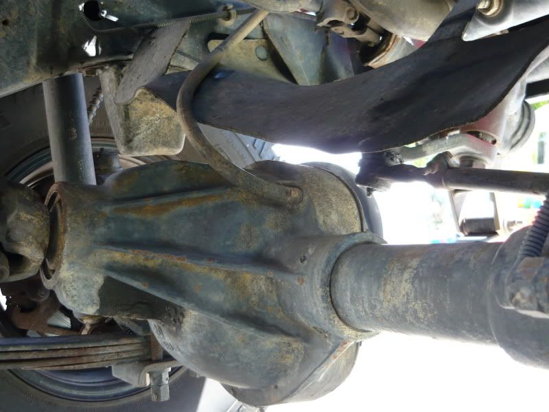

Hey guys, I have a 93 yj when looking under the front end I found a rubber hose dangling down. When I found the top end its looks like is a vent hose of some king and has a plastic vented cap on it. The bottom end has a plastic fitting that looks like it should plug into something. The only thing I can think of is the vent for the front Dana 30 differential. However, I cannot find a hole in the differential for it to plug into. Any suggestions???

Should be on the back side of the diff, near the top, passenger side. At least that's where mine is on my 95.

Keep looking, it's on the back of the pumpkin.

Thank for all the great information. Now all I have to do is brave the Seattle rain and crawl underneath and find the right spot. The pics and diagrams will help a lot. Thanks again guys.

Hey guys, I am having the same issue. I know where it goes but I cannot get the darn thing to stay in there. Mine has the plastic piece attached to the hose. Do I need a new plastic piece, does it snap in? Can someone help? Would appreciate it!

If you look at Mean Max's picture, he has a small hose clamp. Found in any parts store. Use that to hold it onto the differential vent.

Yes a hose clamp would work if I could get the little plastic piece attached to the hose to stay in the hole on the differential. Putting a hose clamp on the hose would just keep the little plastic piece in the hose, it would not keep in thing in the hole on the diff. Sounds a little complicated of what I am saying, maybe I could attach a pic. Would that help?

When I had my axle in the shop for the locker installation I had the guy tap the vent hole and screwed in a barb fitting; no more loose hoses.
