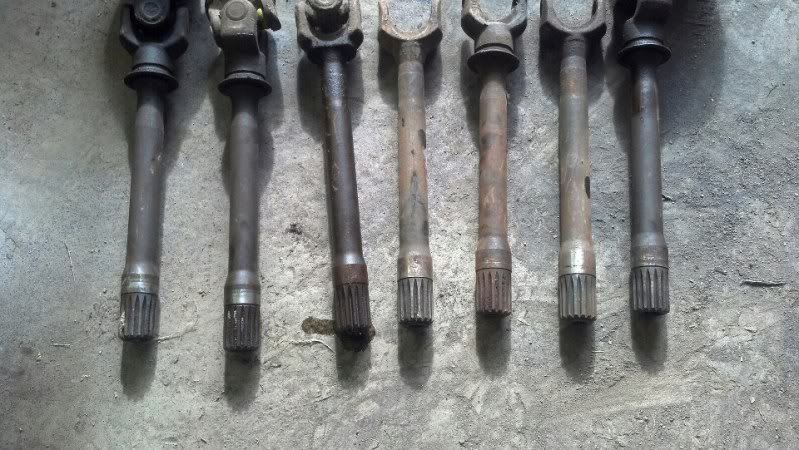

This:
Fix it and carry spars like I do

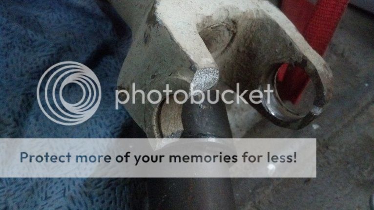

It happens !

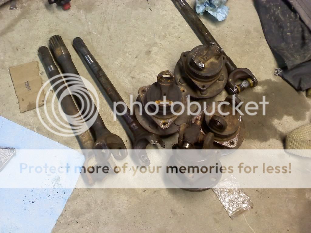

Junkyard shafts from a 96+ XJ with the larger joints- axle tube seals and genuine Spicer 5-760x joints is what I am doing- I broke my shaft last time out too. I figure I have wheeled it the way it was on 35s for a while before it broke. I will now have a spare set of shafts so I will be able to fix it if it breaks again. IF I manage to break it again then I will probably spring for the cromo shafts- JY shafts are only $21 each at my local Pick N Pull and I would want to put new joints in any JY shaft (my spares I will keep as pulled from the JY).
All together I am only into this swap ~$150 and most of that $$ I would have had to spend even if I did the cromo shafts (new ujoints and axle tube seals).
