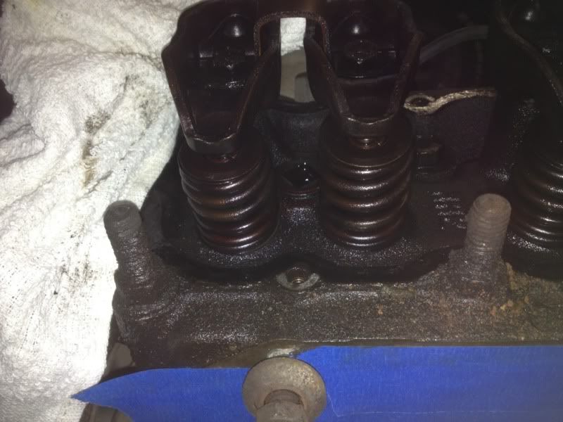

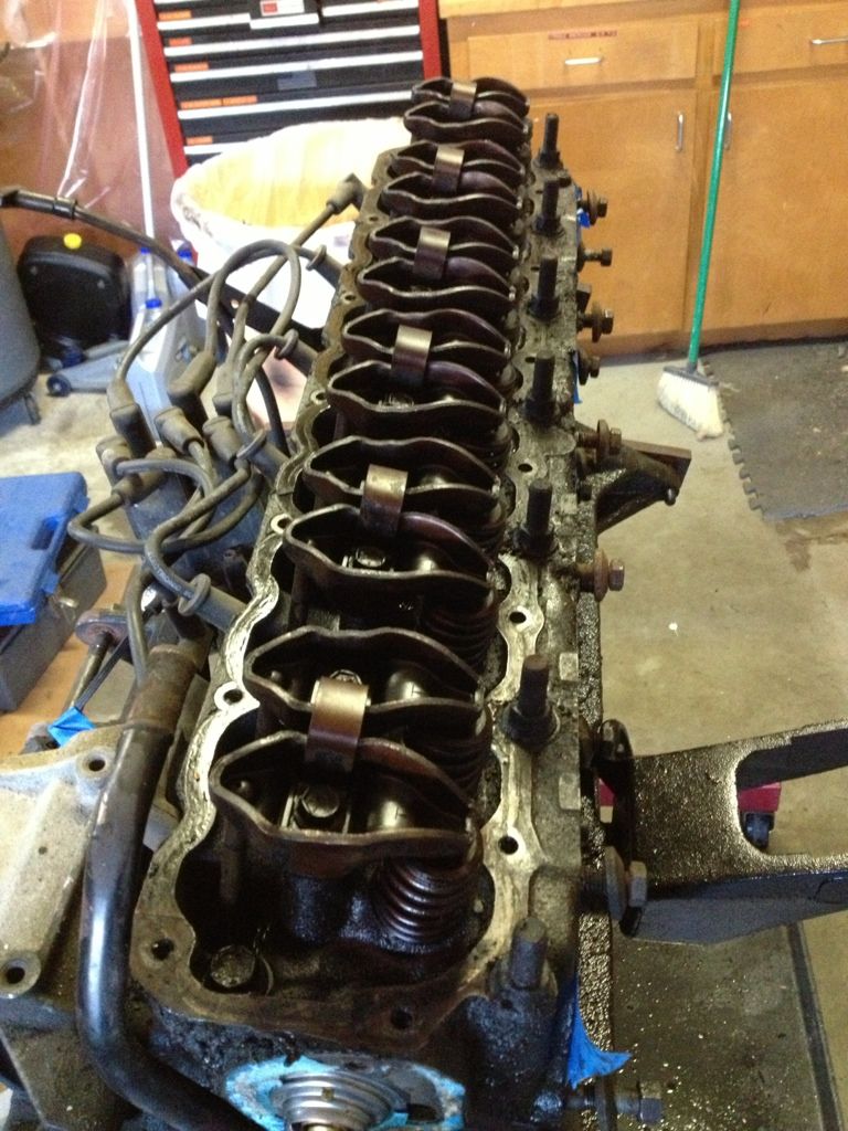

INSIDE OF MY VALVE COVER
VOZ™

post #23 of 54 Old 02-25-2013, 04:51 PM Thread Starter
voz
Location: Clayton
Posts: 199
I does not look bad at all..
VOZ™
voz is offline

It looks great! Are you going to cpmpression test it on the stand?
